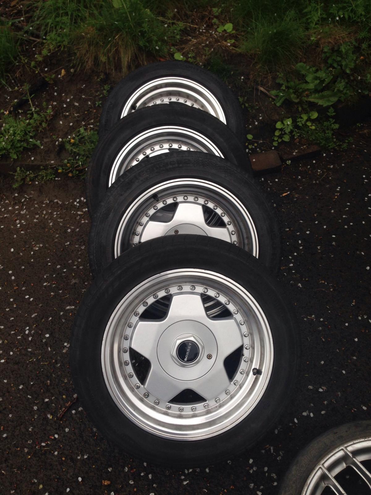

Borbet rims... What tyres?
So I picked some borbet rims up earlier, they have tyres already but need replacing...
The fronts are 16x8j and the rears are 16x9j.
They currently have 225/50 R 16 tyres which look ridiculously big.
What size tyres would you recommend, with maybe a little bit of stretch?
Would my original 205/45 R 16 tyres be of any use on the front maybe?
Any help would be much appreciated!
Many thanks,
Jamie.

Test fitted the front (8j) today with the 5mm spacer to clear the shock and the wheel sticks out ridiculously! Is there any legal requirements for this??
It still has the 225/50 tyre on, so that probably didn't help, but with a stretched 205/45 tyre on would that not look so bad?

uru4ynap.jpg that's them on my mates car
I think they are borbet reps? Picked them up fairly cheap...
