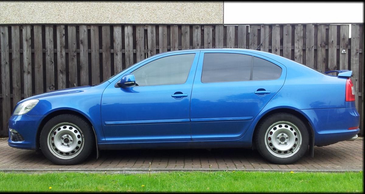

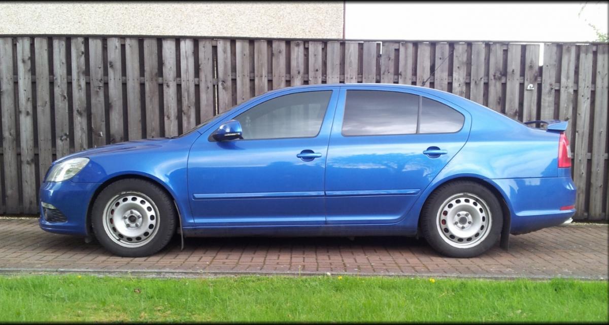

H&R -50mm kit fitted (with pics).
Full suspension kit fitted last night. (Pics show winter wheels, changing at weekend).
Also got a Whiteline RARB fitted on medium setting.
Height to top of wheel arch.
Before:
Front: 665mm
Rear: 674mm
After:
Front: 647mm
Rear: 651mm
I assume it will drop/settle a bit more.
Very nice ride, not harsh. Soaks up bumps and goes round corners easily and with minimum roll.
Back end used to skip round corners over any bumps on the road. Feels much smoother and safer now.

Looks good that. They should come at this height from factory not the ridiculous arch gap they do come with. I swear 90% of cars on the road are lower than my vrs.

Looks great, I can't understand the ridiculous height of the VRS from the factory. Look at all the new Vag cars that hardly need lowering at all!
looks good, nice height in the "after" pic.  not much of a drop though is it?  20-ish mm.   It'll look better with the vrs wheels back on.
I was expecting more like a 30mm drop but I read somewhere that it settles/drops a bit more over time. I will check it again at the weekend before I put the alloys back on.
That was the -50mm kit as I had read people putting on the -35mm kit or the Eibach kit didn't drop it very much but dropped another 10mm after a while. Glad I got the -50mm kit.
