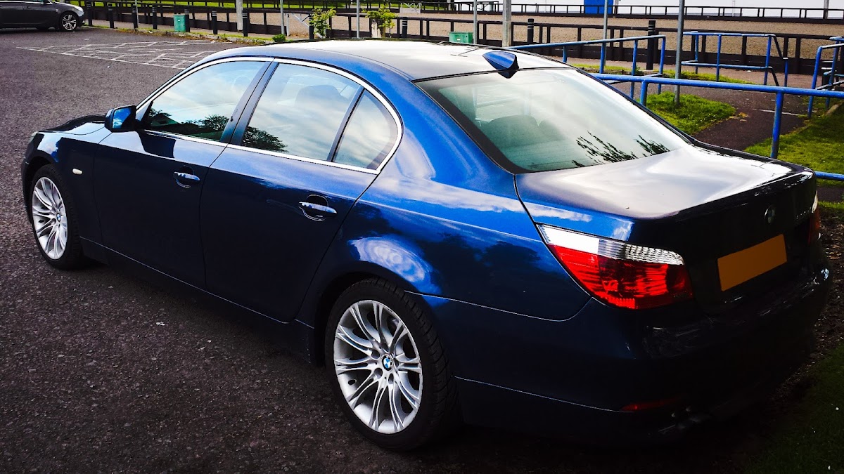

New wheels, yayyyyyyyyyy
M Sport wheels? Absolutely love these the car shape has grown on me hugely!

Looks so much better with the new wheels.  :thumbup:
