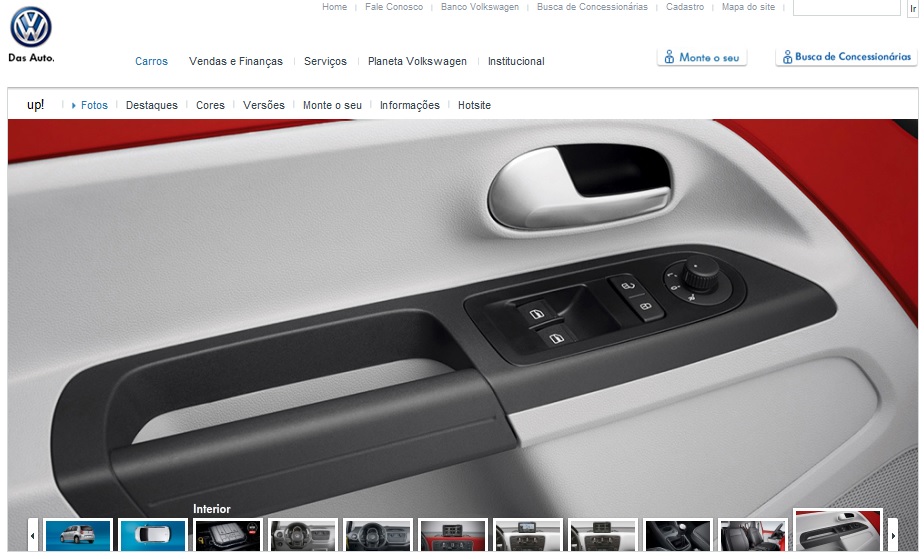

My priority would be the fitting of a passenger side window switch on the driver's side.
That does exist. Look the Up! up on the brazilian VW homepage and take a look ;)

I wonder if the Brazilian double window switches are illuminated too??
Edited by JimmyR
I'll be damned!!
Ooh!

Looking at the photo, that'll put the dual control on the passenger side, but for RHD cars that'll still mean there's no dual control on the drivers side - unless they do a RH door double switch… can anyone check if the part numbers for for LH or RH door trim?
I think the trim goes for both LHD and RHD.
