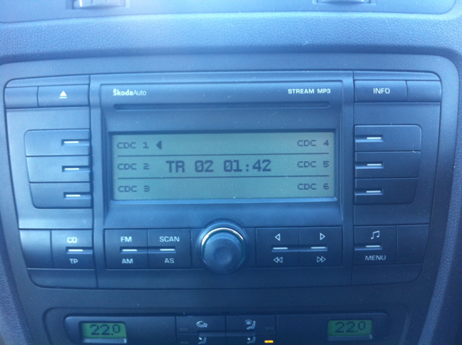

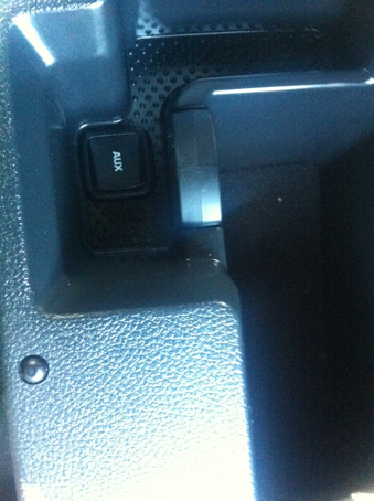

I have an Octavia FSI 06, I found an AUX input in the central compartment and the stereo seems to have an option to turn AUX on and off, but i can't see how to change it to AUX , the only buttons are for CD or Radio.
see pics attatched
thanks
Press the CD buttons a couple of times it should display AUX across the screen. if it doesn't hit the menu button and go to the third internal menu via the arrow at the bottom right. On the top right it will say AUX OFF just hit the button and change it to AUX ON, hit the CD button a couple of times and you should be good to go.
