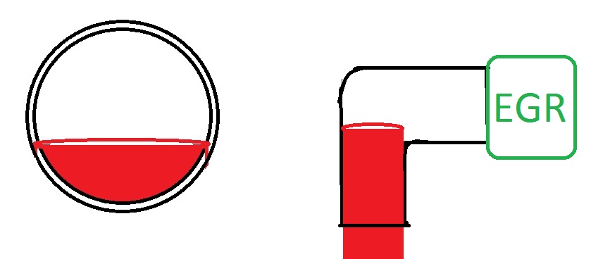

Finally got my arse into gear and fitted my DIY setup for the pipes, only to be massively disappointed. It was as flat as a fart after fitting as if I've got an enormous leak and I can't see from where it could possibly be leaking.
The top of the stainless pipe that goes into the silicone bend for fitting on the EGR is sitting beyond the bend of the silicone, as I've tried to show below
Imagine if you're looking down the end that fits into the EGR. The black being the silicone bend and the red bit the stainless pipe you can see as you look into it.  Would this cause problems?
Potentially, It'll cause problem, yes. Unfortunately, "it depends"... on at what flow rate it becomes very restrictive.

I had it on and off about 3 times, even going back to the old one to make sure it wasn't just in my head. Then came to the conclusion that it was exactly the same, so went to put my DIY setup back on and noticed the bottom IC connection had come out, so it wasn't just in my head. By this point I was sick and just left the original piping on and called it a day. It's making a really loud hissing again now as if the bottom IC bit has come loose again...
I think I'll cut the stainless section down when I get a chance so it doesn't come past the bend and see what that's like.
