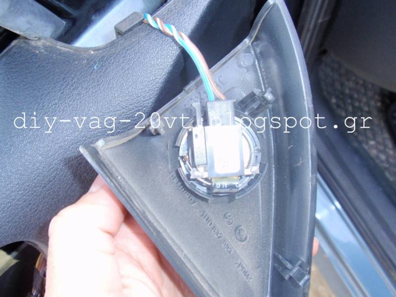

Identify this weird plug in my drivers side door
So, yesterday I'm sat in my car waiting for some people when I notice this funny plug in my drivers side door. I've owned the car almost 3 years now and not once noticed this.
Anyone have any ideas? The wires are blue striped and brown striped. All looks 100% oem to me but theres nothing obvious it should plug into.

Certainly looks like the tweeter plug but how it got there is a mystery, unless youve had your door card off recently
ah, that would make perfect sense. I've never had the door cards off so must been like that a while. Is this the speaker that people usually unplug? Or was that the rears?
Cheers for the help guys!
Why would anyone unplug it??
No idea, more interestingly why was the door card off in the first place?
Someone fitted aftermarket tweeters?  You would in that scenario remove and unplug the oem tweeter I think.
Just pop the tweeter off and have a look
Yep that's a speaker connector, as mushtafa says it's probably off the tweeter.
