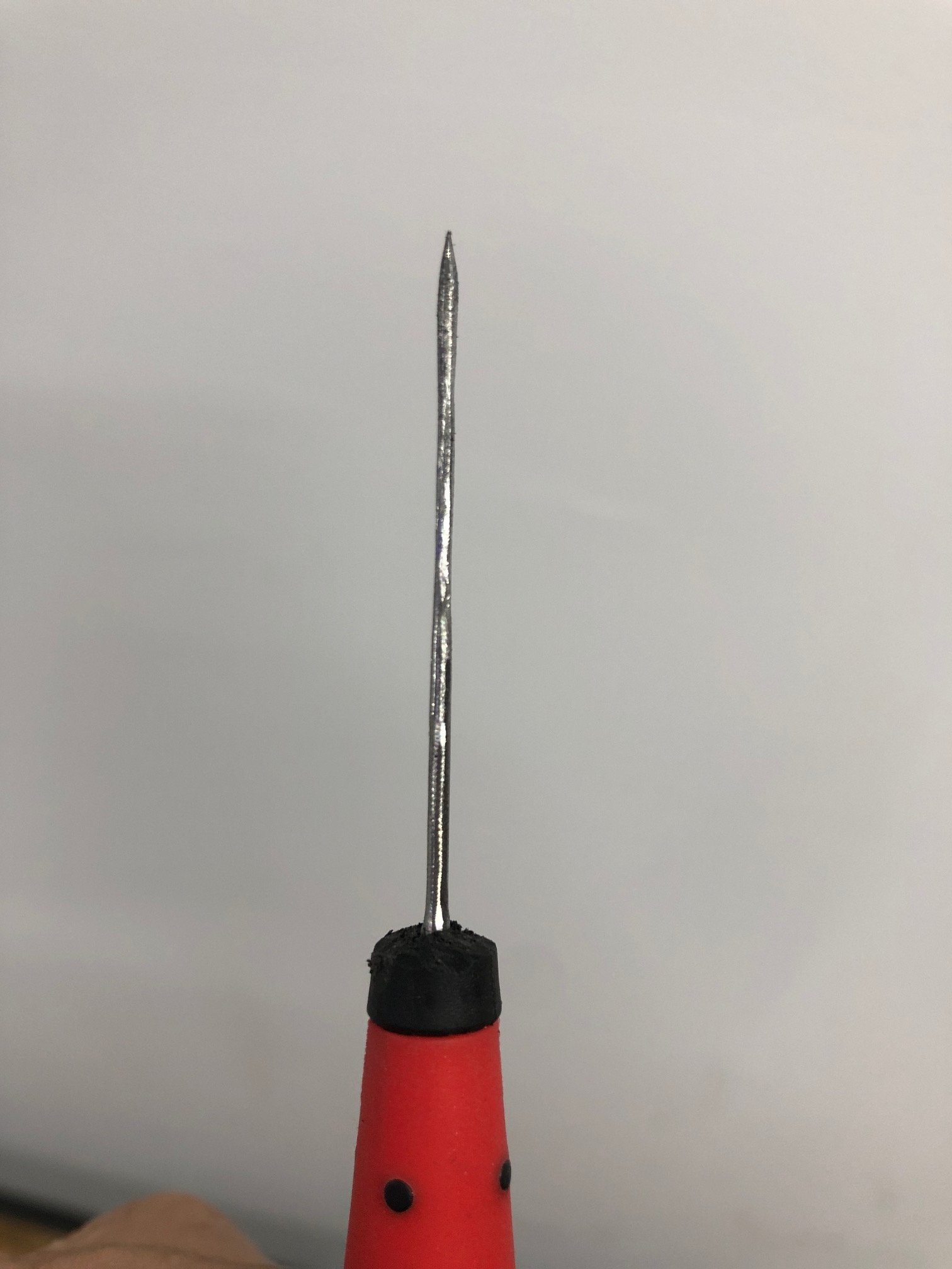

this problem will come up from time to time, as it did for me recently; so I thought I would add what I discovered.
My immobiliser aerial did NOT pop out as easily as demonstrated in the videos around.  What fixed two days of frustration and a whole bunch of unnecessary removal of steering column parts was making a Pin "Tool" out of a Philips head mini screw driver.  In the end, after 5 paperclips, a hex key and stabbed fingers, the Philips head screw driver did the job second go.  But, I had to give it a good shove into the hole, and that's the point I wanted to make.  All the paper clips bent, and the hex key was too "blunt" at the end to find the hole within the barrel.
Hope this helps someone out there.
