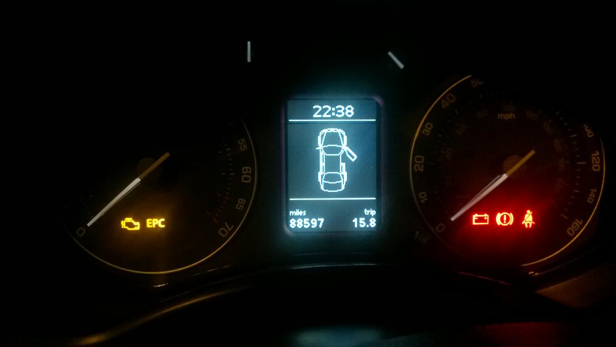

Do you have an example of this illuminated needles on ?
:rolleyes:
Not in a Skoda
but here is a VW one I did
https://www.youtube.com/watch?v=hTVNndFour4
Hold on 5 minutes....

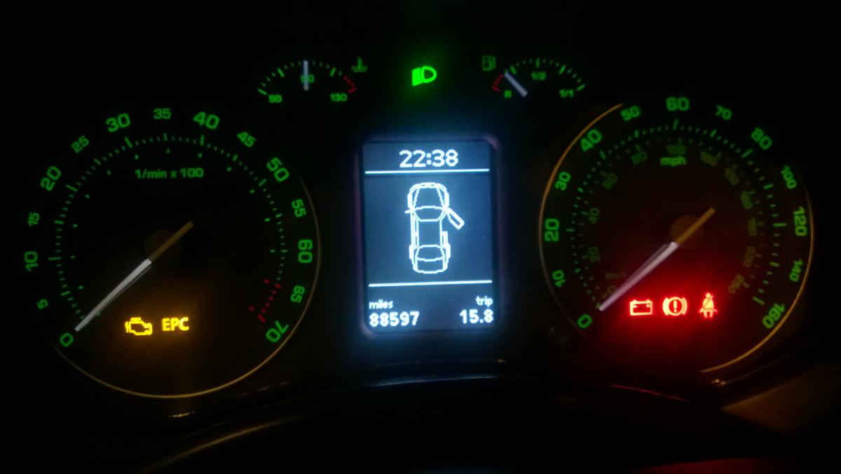

See attached. lights off and on.
Well, Eddie, Neomancer...Bravo!!!
:rolleyes:
Well done, like it very much.
I have a 07/2007 VRS TDI PD with maxidot...is it possible to make it like this ?
Again, Eddie you Bravo!
And this...very, very..nice ;)
Pretty sure staging is not possible on a pre-FL.
Would love the illuminated needles though.
How did you do this Eddie?
Phil
Ah yeah. True!
I bet he's read the eeprom from the cluster and changed the coding then re-written.
When i was reading around for the previous car this is how it was all done.
Not just a matter of a simple VCDS tweak.
Phil
