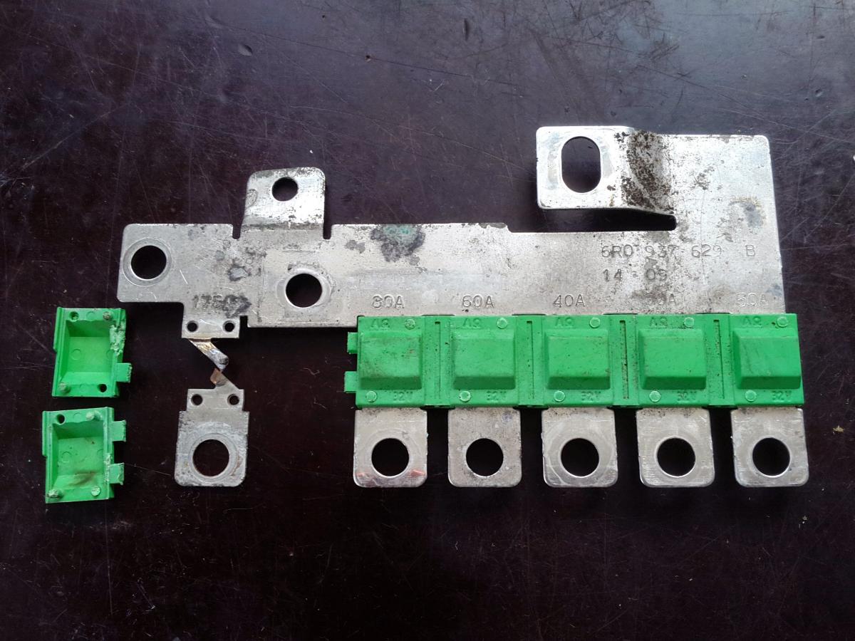

So earlier my horn that I fitted decided to stop working! After a few different ways of wiring I realised that the orignal position it was wired to on the battery is the problem! I can only assume that it's the fuse going to that point! Any ideas where the fuses are for the battery connections?
on top of the battery!!
Sent from my GT-I9505 using Tapatalk
I did think that myself but I can't find anything! I think I'm just being a fool! I can manage to take every panel off my car and wire up lights left right and centre but can't find a god damn fuse! What is wrong with me! Haha
They look like this when 'blown'.
