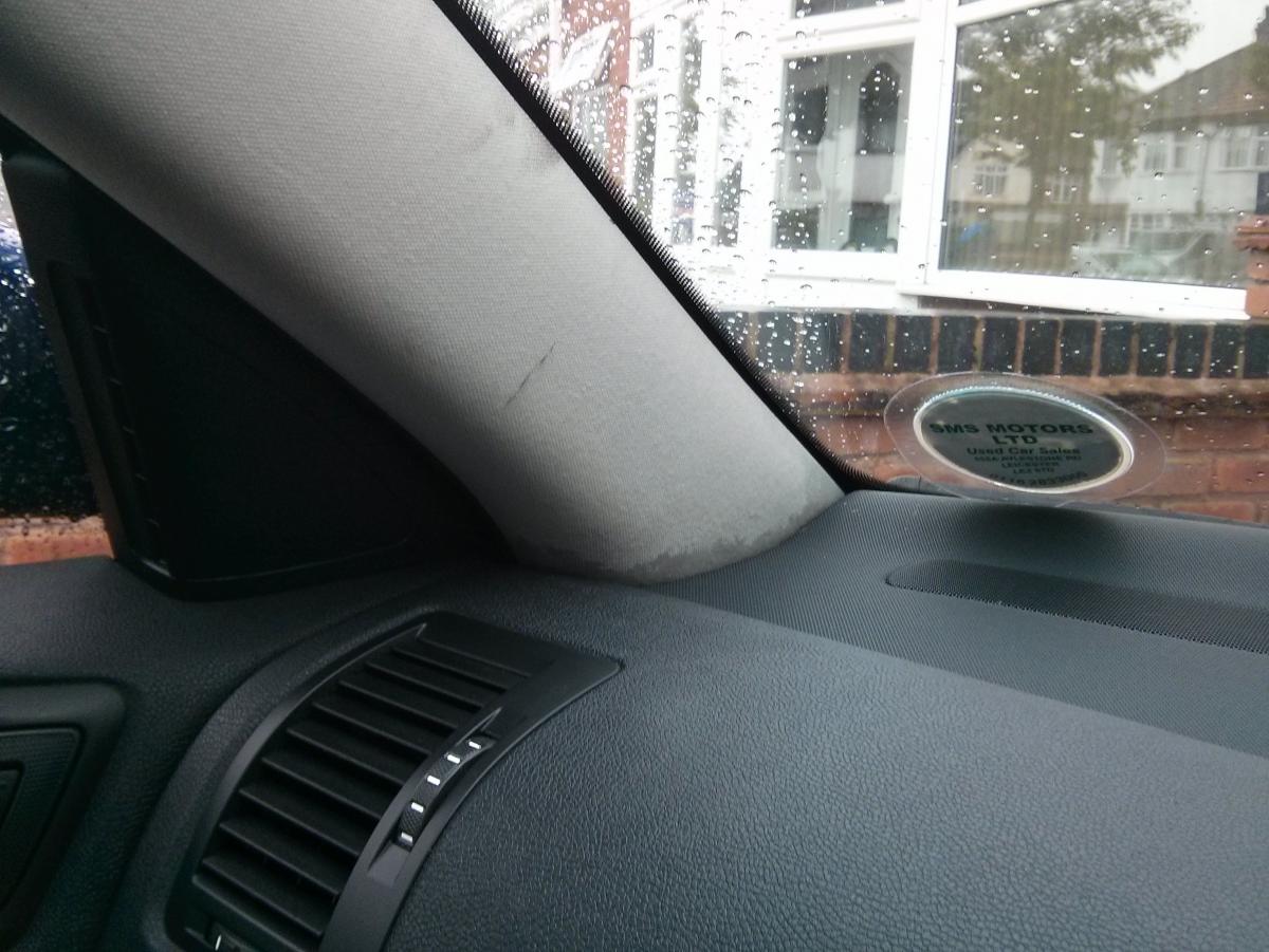

  • I also now find a leak today...in the passenger side at the bottom of the pillar above the dash (photo attached).

Id say you are going to have to give them a chance to fix it,are they going to replace the timing belt? Has the car had a replacement windscreen recently? if so it may not be properly bonded in & may be the source of your water leak,the door seals on the octavia are not the best at times as well. If the fix the air con keep a eye on it as the may just re-gas it rather than fix a leak,the compressors are a weak point on the octavias.
