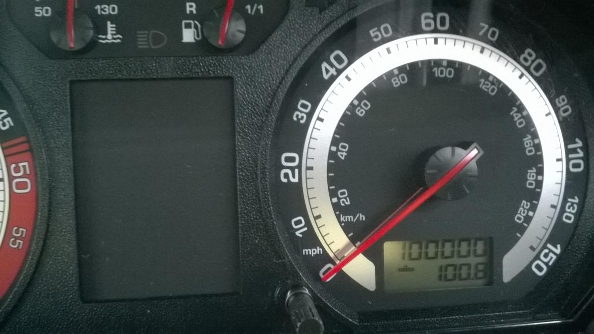

post-68219-0-76250200-1402435414_thumb.jpgHi All,
I've not posted for sometime now so hope I'm not treading on any toes...
First, I'm considering taking my Fab off the dealer service network due to costs/benefit analysis.  Can you recommend any Independent garage who specialise  in VAG group cars in the North London, North Herts area.
Second, while i'm at it, what 'mild mods' would you recommend.  Not really interested in silly bolt-ons and neons (my max power days are over lol) - for a start, i'll need to change/upgrade that valve thingy which makes the car semi jack-rabbit when changing up/down.  Probably a remap for performance and economy.  I've no idea what kinda price i'm looking at so would love your input.
Lastly for now, I have arms like Popeye due to the horrendous steering offline (veering off to the left).  I've had alignment all done and is 'spot on'.  Technician advised i probably need a geometry set up.  Any ideas/recommendations?
I'd love to get back to the days when I serviced my own cars, but kids, wife, pets, work, weather and F1 all now 'get in the way!
Sorry for the essay.
Cheers,
Rob
