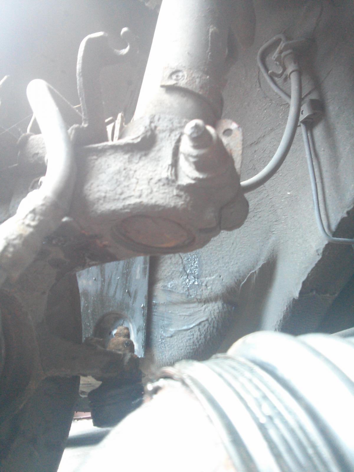

Just doing my cv gaiter.
Is this any help?
Mine is on standard springs & shocks afaik

Is this any help?
Cheers that's exactly what I wanted. If I move it down 10mm it shouldn't be close to the drive shaft (I know it's out on this pic) and there's enough of that locating spline/plate thing to drill for the bolt to pass through to secure it so it doesn't move
