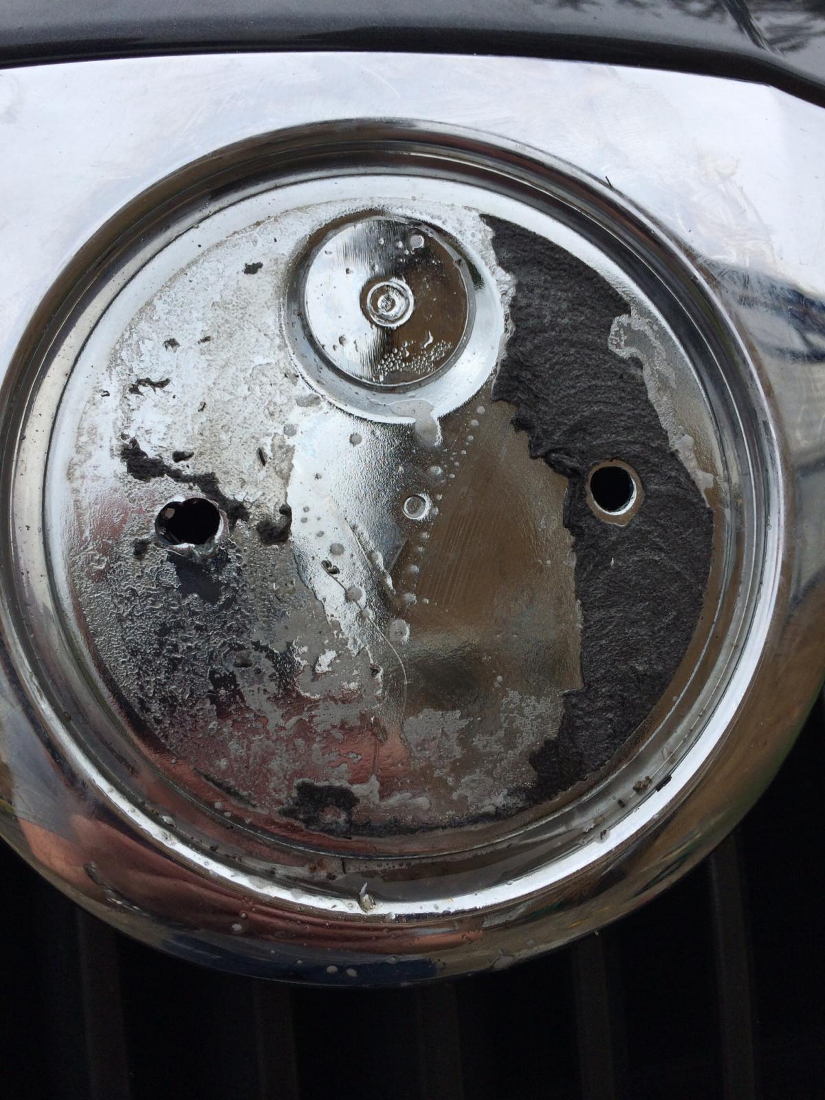

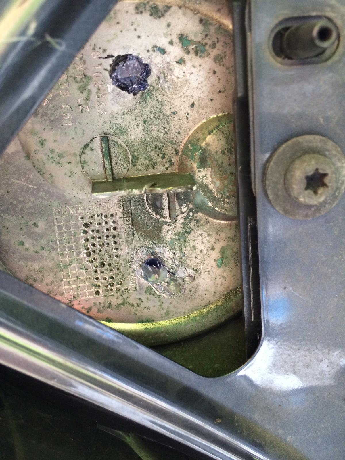

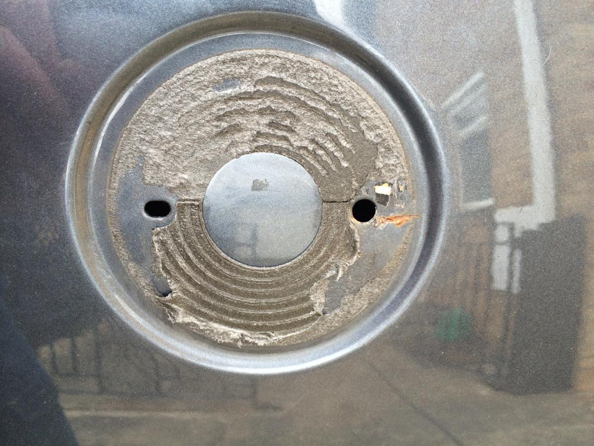

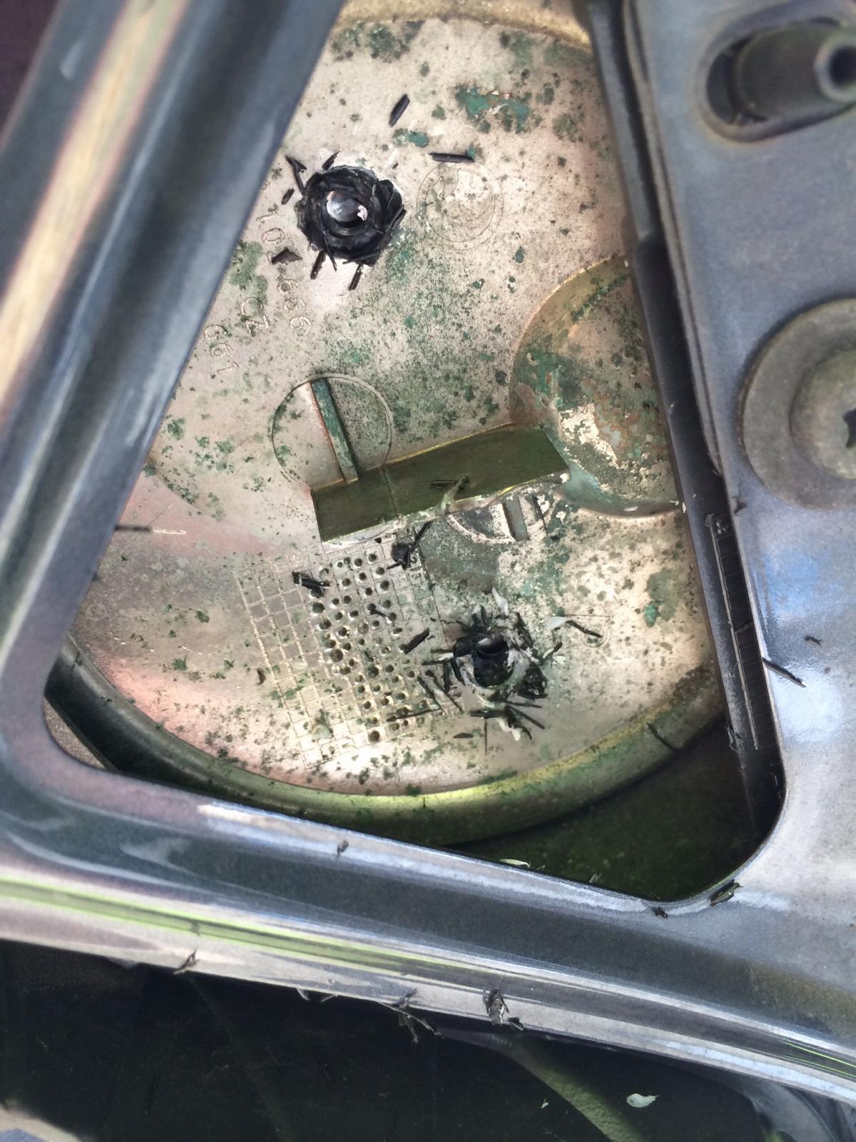

1) From inside the engine bay, drill the 2 little plastic lugs.

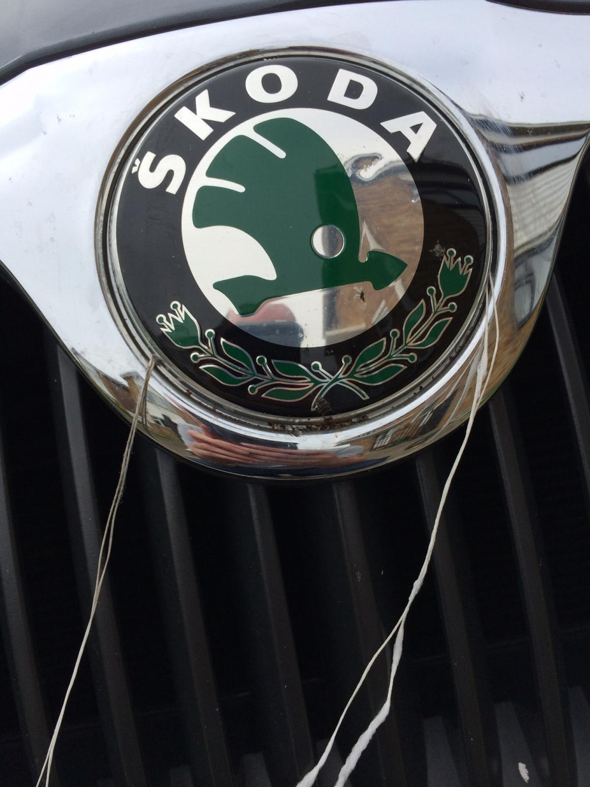

2) Use dental floss and from the outside place behind badge and use a sawing motion to remove the old badge, PS this take some doing.
3) clean the surface area, removing the old glue / tape
4) remove plastic lugs from rear of new badge

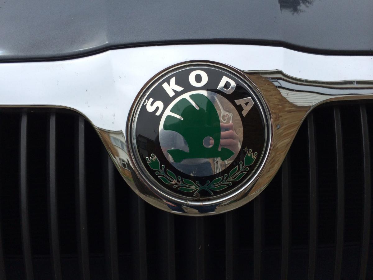

5) place new badge on
6) I used a glue gun on the inside of the badge / 2 holes to double secure the badge.

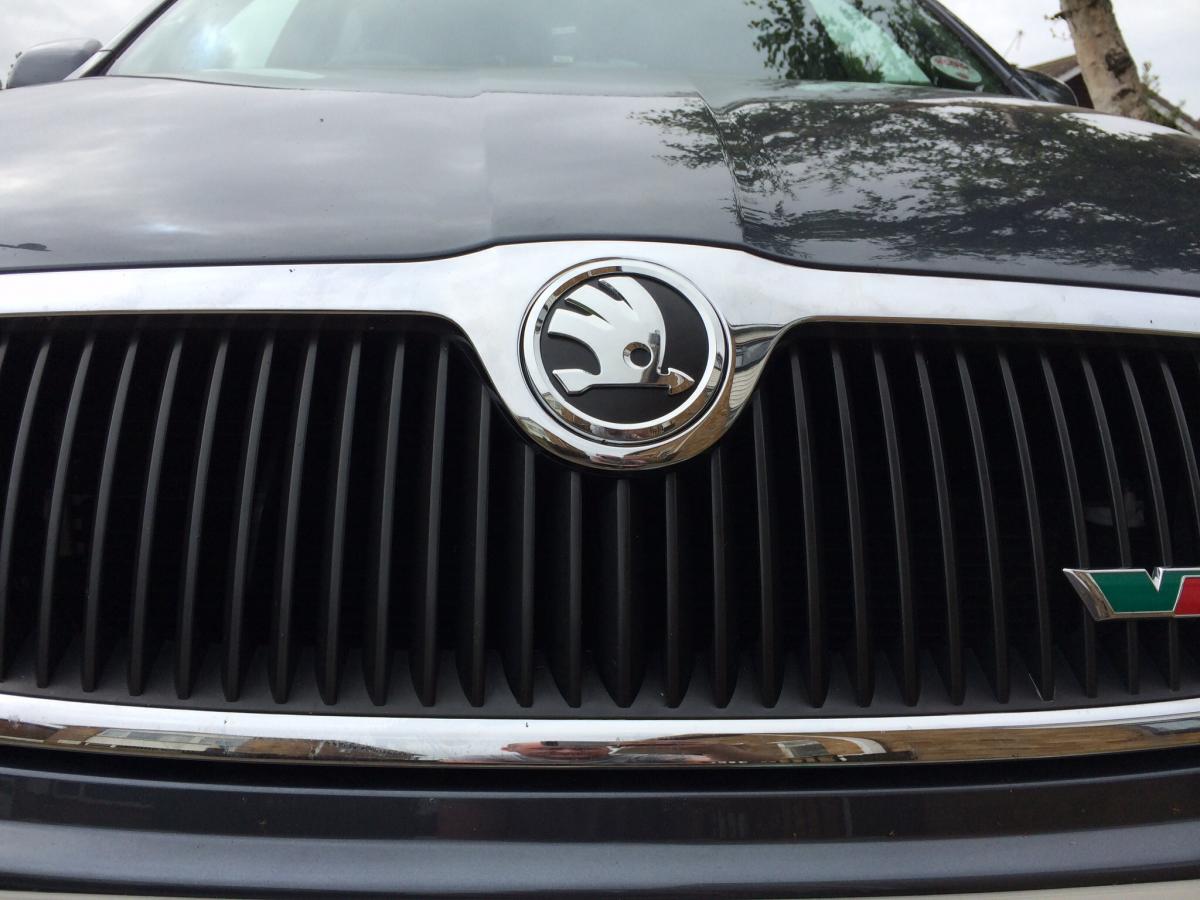

7) stand back and admire the new badge

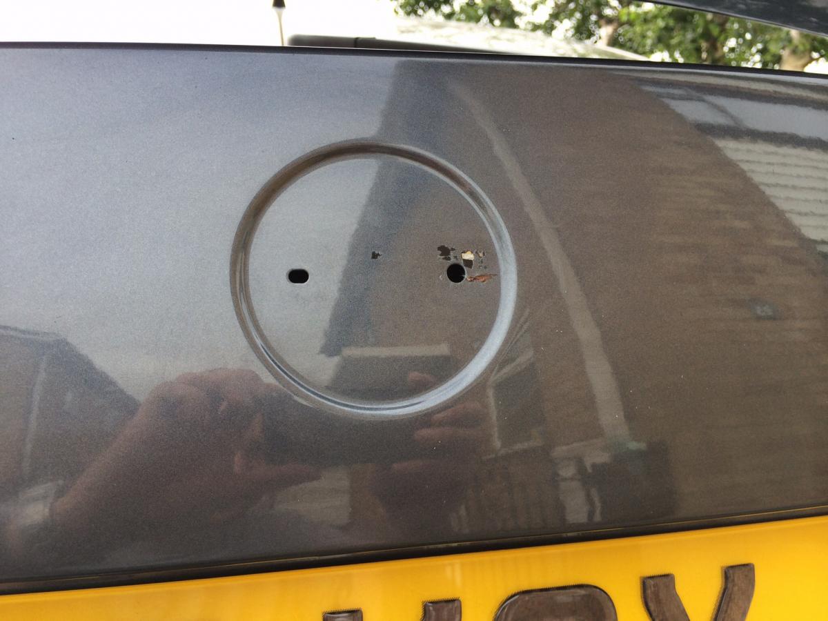

1) again using dental floss place behind badge and use a saw motion
2) there is 2 plastic clips in the middle area
3 remove enough glue / tape and then using fingers remove badge
4) clean area again
5) re install new badge
