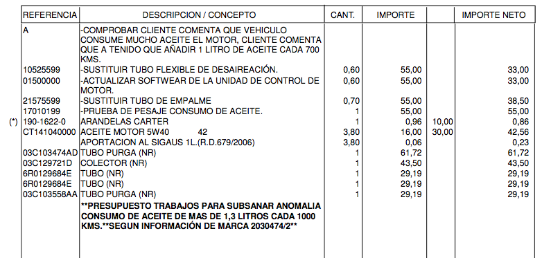

As a part of getting the oil consumption fixed, I had oil consumption test done. Due to me not speaking the local language well, I am having trouble explaining the bill to my extended warranty provider.
On the attached image, I understand the first part - the oil, software update + work.
However, how are these items related?
03C129721D COLECTOR (NR)
6R0129684E TUBO (NR) (2x)
03C103558A A  TUBO PURGA (NR)
Found some of the parts in the parts database, but I am not much wiser.
Any help would be greatly appreciated!

From the Numbers, it is
Intake Manifold Rear.   38 Euro
Connecting Pipes.        25 Euro
Vent Hose.                 27 Euro
So they did the Breather Pipe/Valve Mod  & ECU Update.
Did they do a Draining of the  Oil,  Fit new filter, Fill with New Oil, Drain & Weigh,  Refil,
& send you on your way?
??How many km to cover before they drain and weigh the oil again.
What was the weight of the Oil at the start of the Consumption Test?

I do not have any more details re. the weights - this is the only document I've got. Is there any way to get information from the ID SEGUN INFORMACIÓN DE MARCA 2030474/2*?
Lastly, how do you recommend I describe it to the warranty company? Their initial translation was that this is some kind of air pump and is thus not covered by warranty. In my extended warranty coverage it says that every part connected to oil recirculation is covered, I guess I will make argument there.
