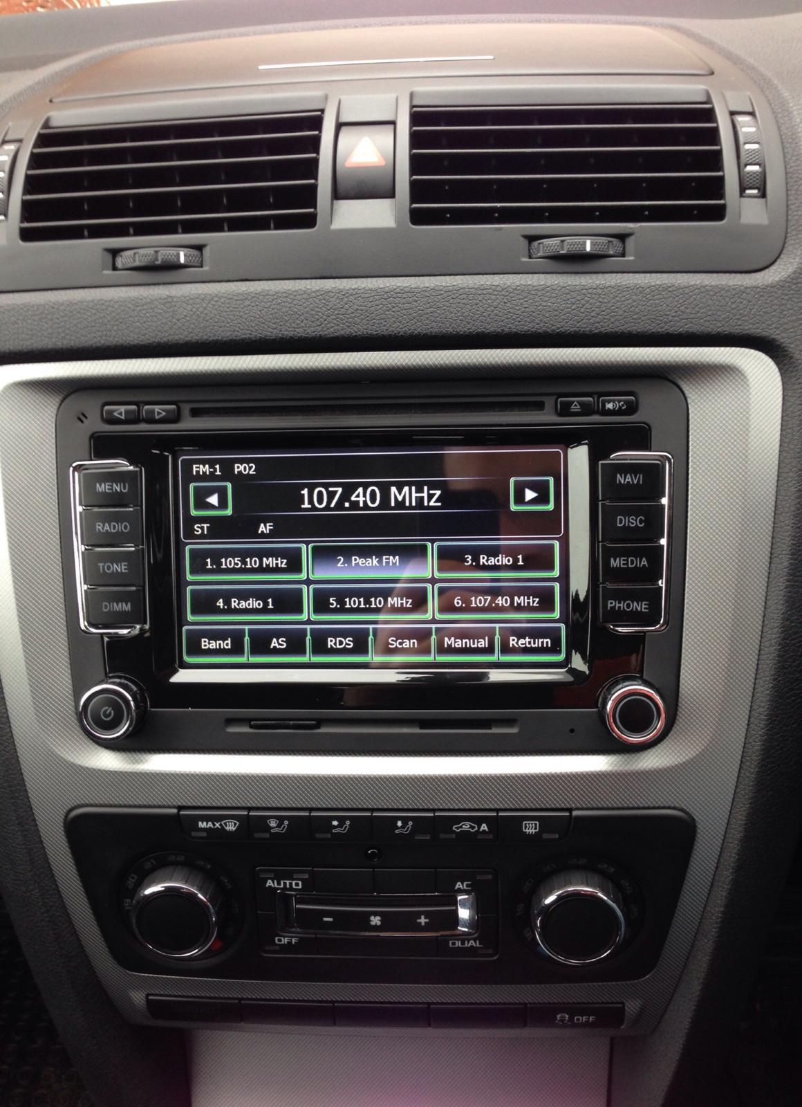

What will be different is when you switch it on it will show either a VW logo or the Seat logo for about 5 seconds, and the buttons and menus will be red instead of green. Operationally everything is the same. The red is only a problem if you are seriously OCD ;) ;)
Even though the picture shows parking display, it won't work in your car as the car is PDC and the headunit it OPS. You can change from PDC to OPS, but it is a bit of a faff.
The pictures don't show if it's got RVC on it or not.

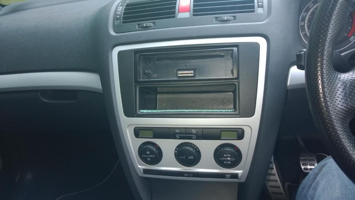

Photo attached is my unit in the car now
You will need a new surround if buying that stereo from ebay.
Your surround is for a stream or Balero sized head unit which has a larger face.
You need the same size trim as for fitting a Columbus like this, but the pre fl version.

You would need a new fascia too. (For either Columbus or RNS315).........
Black: http://www.skodaparts.com/product/octavia-navigation-trim-2004-2008-31876
Silver: http://www.skodaparts.com/product/octavia-vrs-radio-trim-31881
