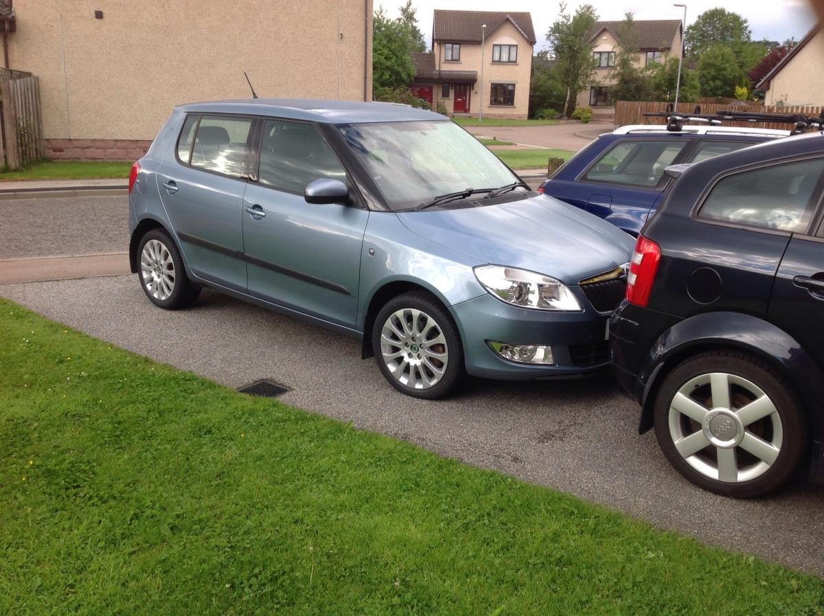

Update folks. Picked up the car on Saturday. I had the alloys professionally refurbished, then I steamed cleaned the interior and treated the bodywork to a coat of Collinite 476.
Looking back through the history that came with the car - the EGR cooler was replaced at 27k miles back in April 2013. Looks like it was done under warranty.
