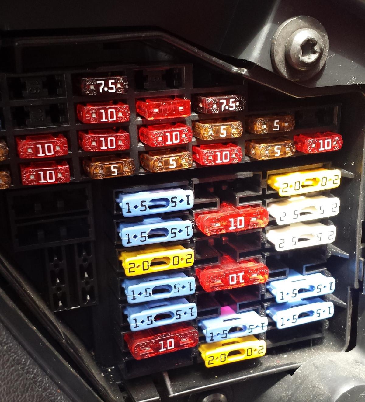

I have checked the F24 fuse on this fuse layout and replaced the fuse to no avail:
http://www.briskoda.net/forums/topic/231820-identifying-fuses-back-to-front-pic-wanted/?hl=%2Bfuse+%2Blayout
I have also checked this link and looked at other fuses, i think the octavia he has is a little different as when i checked Fuse 15, its a 5 amp fuse and it seems to be ok.
http://www.lookatbowen.com/2009/01/skoda-front-wipers-stopped-working-a-fix
If anyone can point me in the right direction, id appreciate it. I have attached my fuse layout just in case it might be a problem with fuses.
Thanks.
I would be looking at the windscreen wiper motor and linkage rather than the fuse.
Thanks DGW, would it be costly to get fixed? Would you know? Much of a job?
It seems like the linkage has seized.
