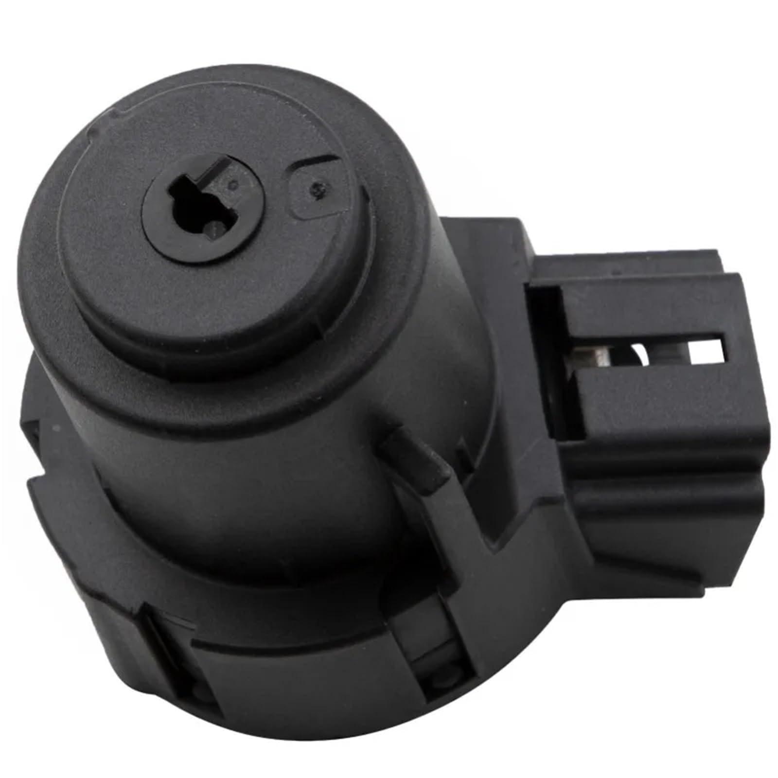

Yes on my 59 plate Fabia Estate I had exactly the same problem when I picked it up as a Skoda approved used car. The key would not operate the ignition switch easily. Felt like it would not turn at all sometimes and on one occasion I could not start the car. Later on when the interior of the car had cooled down, it turned much more easily, but was never great. If you continue to use the lock like that it will eventually damage the discs in the lock, and/or the key, and you will need a new ignition switch. However, it was not the steering lock and rarely is. It's the discs inside the ignition switch. They needed lubricating as sometimes they can stick. Your ignition switch collects all sorts of debris over time, including fluff, dust, bit's of zinc and tin from the keys and this gets into the slots where the discs operate inside the barrel. This make the discs stick especially when the car is hot inside. The ignition switch is self lubricating normally but sometimes after a bit of use it needs some help. CURE: before you do this if your car is under warranty you may want to take it to your garage to have this done just incase of any consequences afterwards, but that's unlikely. Many garages won't charge you for this if you know them. Generally it's not good to go willy nilly spraying things into the ignition switch and you do so at your own risk, please bear that in mind. As a keen biker I do this on many machines as it's very necessary. Bike ignition switches tend to get quite dirty over time and I've never had any bad consequences. However, in reality it's ok to squirt some small amount of WD40 or other NON-OILY lubricant into the ignition switch. Do not use anything like 3 in 1 oil. It will bugger up the ignition lock as it dries out causing the discs inside the lock to stick and you'll be back to square one. But go easy with whatever you use. Not too much, you don't want the barrel full of WD40 incase it leaches out onto something electrical. You want it to evaporate quickly after application.  But WD40 has a zero capacity to conduct electrical power so it's pretty safe.  Put some on the key also. Then push and pull the key in and out of the ignition and start the car. Mine was really bad and WD40 cured the problem, lubing and washing out the debris from the discs in the barrel; the ignition is like new again. That was a year ago and no repartition. Incidentally, the dealer will normally do the same thing as a test to see if the discs are damaged. If after WD40 it's still the same you may need a new key or switch. Also you may like to test your car's second key before doing the above to make sure it's not some problem with your normal key that you use.  Good luck!

" However, in reality it's ok to squirt some small amount of WD40 or other NON-OILY lubricant into the ignition switch."
This is good advice -
when steering locks first appeared on the motor scene - all manufacturers went to great lengths to advise their franchises that in NO circumstances should oil be used to free off a 'stiff lock system.
Better yet, use a graphite spray, which is specifically designed for locks.
I bought mine at Maplins.
Graphite is no longer recommended for disc locks as it can cause sticking. It can also conduct electricity. Is yours a fluid or powder spray?
It's a fluid spray.
Ok, the fluid spray is a little better as it distributes the lubricant just a little better than the powder. But not good in an ignition switch due to possible conductivity issues. GT85 or WD40 is best.  Graphite fluid spray can be used ok on the door locks etc. Glad you raised that issue np.
I had a similar situation for a while a few years back. Students struggled to start the car even though I had the "Knack".  On getting it serviced, I asked the dealer to look at it and first time, I think they just "Forgot" but on my return, they used a small tin of lock lubricant and its been no problem ever since. I think it was tight and after lubing, loosened up a little over time. However, a squirt at service time will keep any future problem at bay, methinks!

I tried that, didn't work. Breakdown man got it running, but said I need a new ignition barrel. Just wondering if that worked for anyone?
