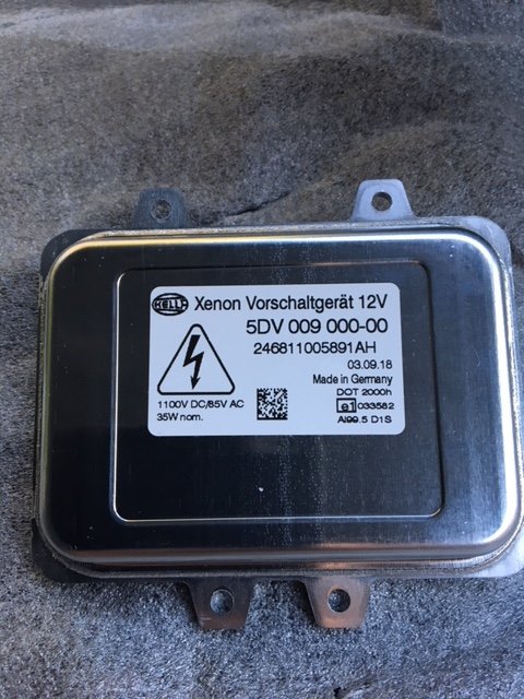

Little update on this.
Quoted £275 for a replacement ballast from Skoda parts in the UK.
I went on line and found this website https://www.buycarparts.co.uk/ where i bought the correct ballast for £83.55 including postage from Germany.
I was worried whether it was going to be reclaimed unit but replacement unit is brand new made by hella that appears to have been manufactured in Sept.
Very pleased now that its fitted and i have 2 lights again and i didnt have to pay nearly £200 more from Skoda for the same part!
