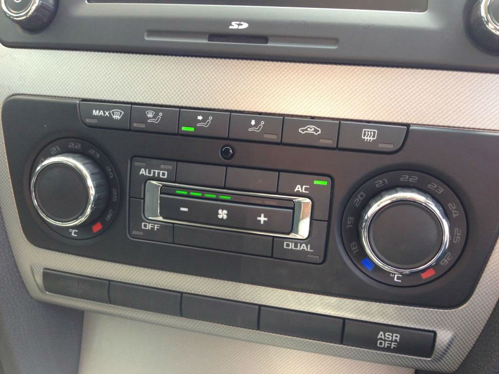

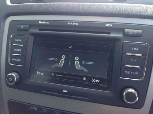

Hi Mike, my car is a 2009 FL I've added pics of the controls and the radio display and I've tried what you have referred to, however I can't see a button marked ECON  !!, mind you I'm going out for another look ?
Yours is the same as mine. The button that used to be 'Econ' is on later cars labelled 'AC'.
^^^^ in that case what did the "AC" button become?
Very different to my 06 Ocatavia and yes I have a messed up Air Con system.
Looking at that first picture, I would suggest that AC is ECON on the later MK IIs.
