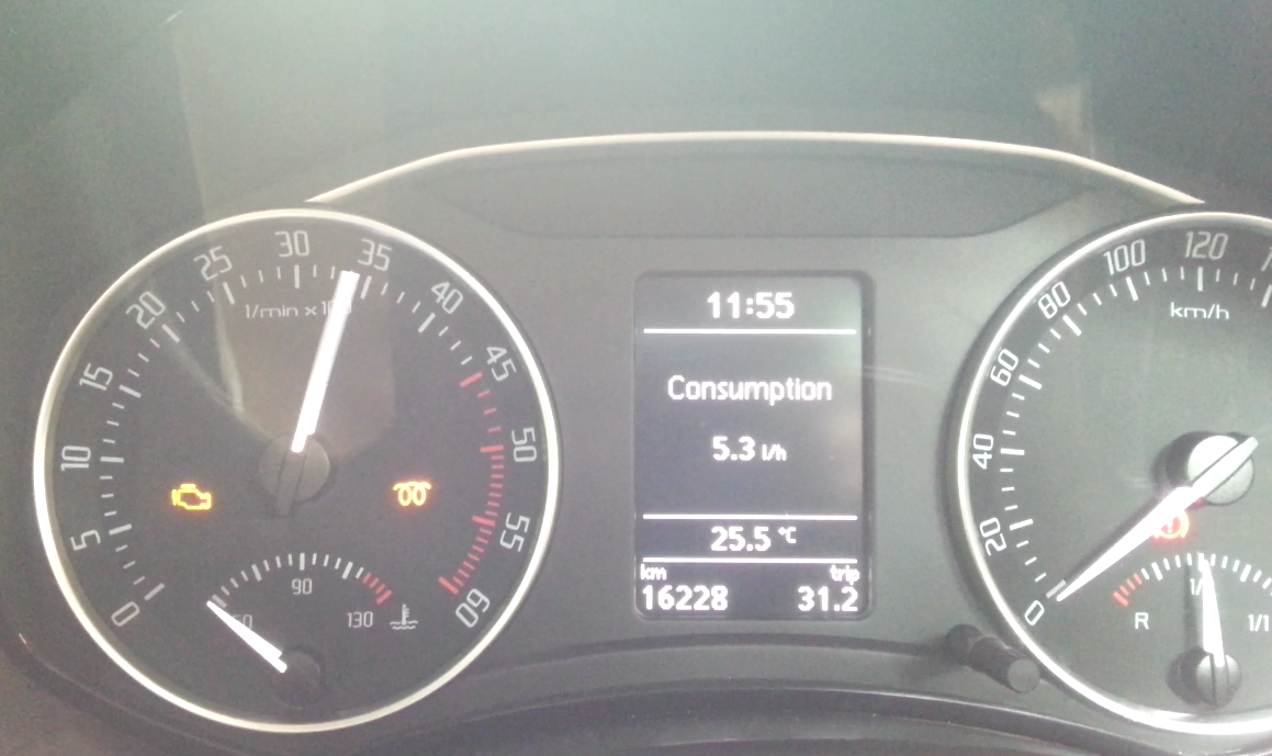

I have a weird issue with my glow light function. When the key is only switched to on position the glow light flashes, but after starting it goes away. However, while driving if I accelerate the car the car just cuts off as if something hit it from behind and in dashboard the glow light pops up when it happens. The dealer said it has to do with radiator fan, and they changed but the problem is not fixed. I knew it wasn't the radiator fan issue since the car didn't have any heating issue. I have video to upload but it only allows 2mb. Please if any advice would be great. The car has 16000kms only.

It would do on both. When driving if I accelerate or the rpm reaches high will just cut off. As you can in the pics while stationary when I Rev high it will cut it too.

That symbol is engine management. It hqs gone into limp mode. They should have scanned it 1st instead of throwing parts at it . Get them to scan it for free as they had you change the fan for no reason. Only then can you tell the fault. I got myself a code reader for £30 on ebay as tired of dealer giving me the run around.
