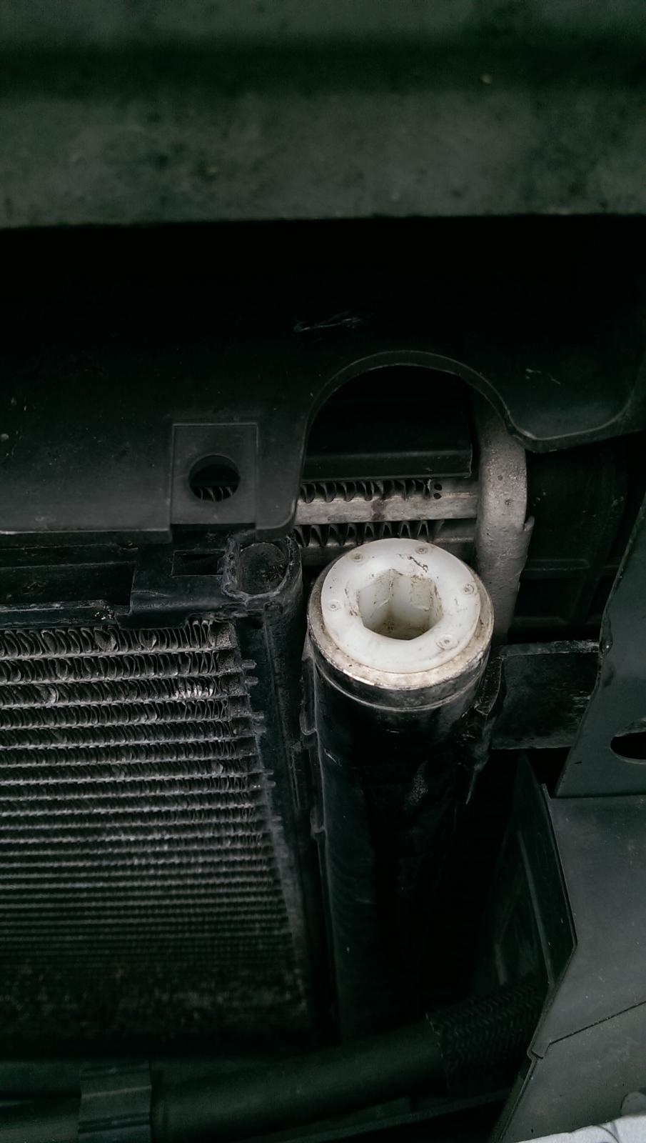

I have a leak in my air conditioning system on my Octavia L&K 2.0 TDI.
It's been detected at the white plastic "bung/plug" on the right hand side of the air con rad / condenser.
Is it possible to get a replacement bung/plug for this? I'm having a real hard time even finding out what it's called not to mind find a replacement.

You might get away with removing it, putting some plumbers tape around the threads and screwing back in.

One thing I do know is that your condenser looks battered, a bit like mine befor I had it replaced.

Unfortunately we could not get it to budge, so with a little persuasion using a heat gun we got it out. Turns out it had been put in there with some sort of bondfix/putty by the previous owner - so the bung now definitely needs replacing.
From my research - that is actually the receiver/drier??
Was there an o-ring on the plug? or a groove where one should go?

Yes, there's an O ring at the bottom of the plug.
The car is 2009.

Isn't the drier just bolted on to the condenser - like a seperate pipe - which contains that plastic bung which is leaking?

...Isn't the drier just bolted on to the condenser - like a seperate pipe...
There are two types fitted to the Mk2. Some are a separate pipe and some are in integral part of the condenser.
The 'separate pipe' type have two screws on the bottom and are replaced. Just to add to the confusion, some have a 'bung' permanently fitted to the top which should never be removed.
The 'integral part' ones are permanently welded to the condenser and have 'bung' (and sometimes a circlip) on the top. You remove the bung to replace the desiccant insert inside.

Is the pipe welded to condenser?
It would appear so.
It would appear so.
In that case you, would normally just buy a drier kit. Undo the plug and hook out the desiccant insert. Use the parts in the kit to seal the drier.
Make sure the condenser hasn't been replaced with an aftermarket one, or you may find the kit doesn't work.
If the drier has been damaged, you will have to replace the condenser/drier.

I actually got it sorted. Got a spare bung/cap cover from a breakers yard - had to cut it as it had a longer piece with a mesh gauze which wasn't in the bung i took out.
Used some plumbers tape around the threading and put it into the top of the receiver/drier.
Got my AC guy to pressure test the system - and whatdya know - no leak any more.
