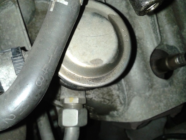

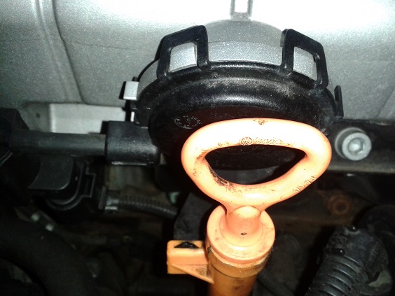

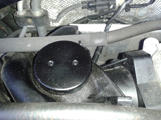

Maybe a valve. There is a cap on the top of the inlet manifold which I don't know what it is. If it comes off or not. Also the cap at the front of the plenum chamber. Will get some photos up shortly.

Got some questions here.
The cap on top of the inlet manifold. What is this for?
Throttle body and tube up to it doesn't appear to have any intake air temp sensor. Shouldn't it be located here?
The valve on the front near the dipstick - is this a one way valve? Can this cause vacuum leaks?
