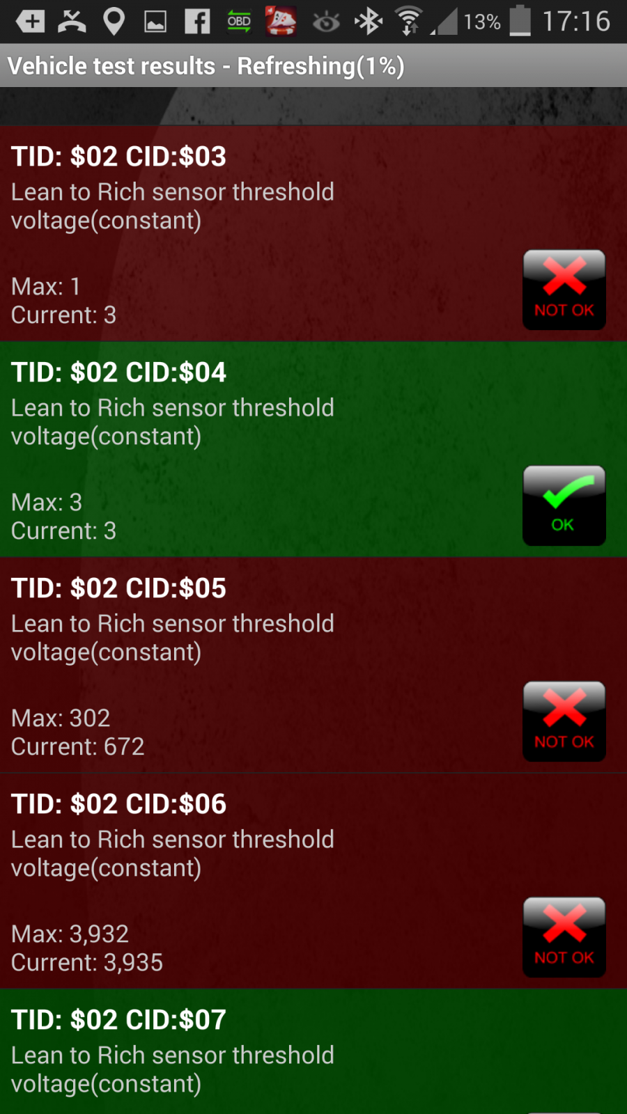

Hi all,
Can anyone help me out with my Torque test results and anything I can do to remedy it?? There seems to be a lot of red on these!
Thanks as always :)
Jack M
Looks like a lambda issue mate, is that the full torque app? As usually gives better results/ explanation of issue.
Probably worth getting a better diagnostic scanner to check over and see results with that, but mixture issues usually result from lambda sensors.
Olly
Sorry, only just noticed the test results option in the app myself the other day. For what it's worth, not sure how or what its working out. But mine we're all OK & green ticked.
