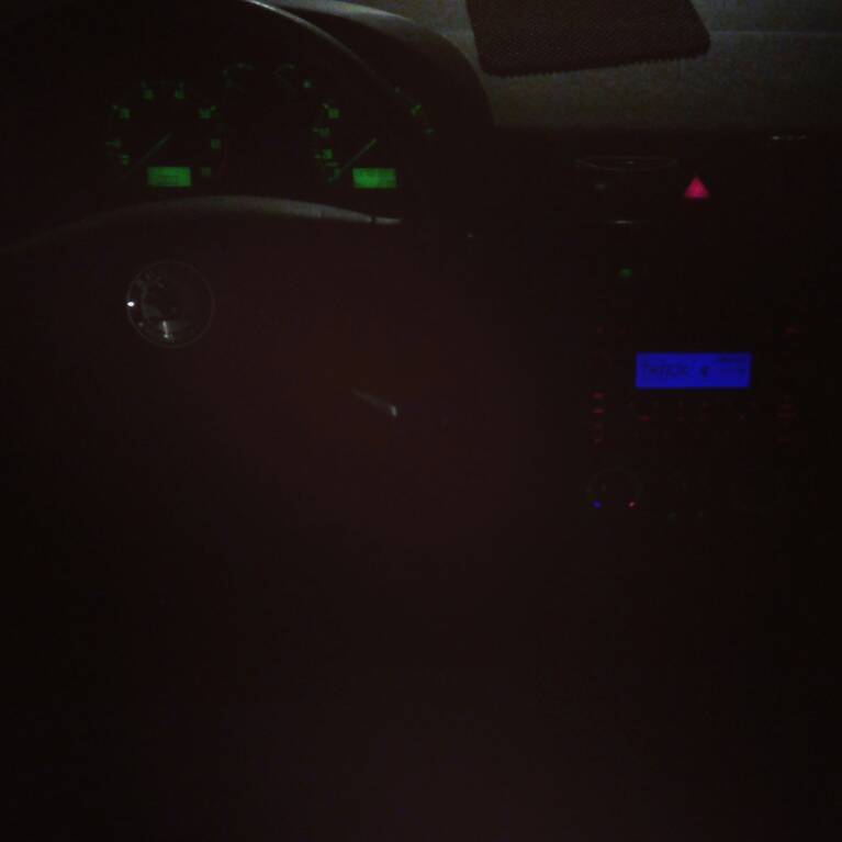

I'm glad that's no longer needed. My electrician didn't want to help me install my delta 6 radio for the reason it can start only with a can bus connection. So after weeks of research and ebaying (looking for an emulator .. Ghhhrrr), I managed to find the quad lock b connector at a scrap yard. Just plugged it in to my pc atx psu (it just needed a 12v positive and ground) and it kicked in. It's looking. great in the dashboard, it has a larger display than the rcd 200 and the sound...I'm not sure if it's just me, but it's way above my exKenwood. post-114013-14082244427184_thumb.jpg
It's playing now only audio cds, because I don't have the antenna adapter yet. I'm looking further to buy one, a second set of speakers for the back and a USB - aux adapter for the head unit.
As for future plans, I might consider replacing the delta 6 blue LCD screen with a green one.
