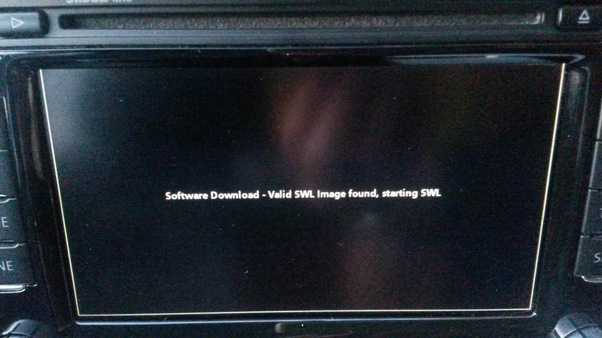

Tried to follow the sd card instructions to the letter, inserted things in right order, came up a 'software update' screen, then hung on one of the SWL screens
Could only remove disc by doing soft reset, then system wouldn't start (Skoda logo and red lines top and bottom)
Now having to reload 4020a again :-(

Mine hung on this screen, Phil, didn't even get to a %age
Ah right... annoying!

Nope, forgot that :(
Brimma
You shouldn't need to reload 4020a again. It's only the map partition being affected. By retrying it should overwrite any partially copied files. Perhaps the supporting disc could do with a re-burn.
