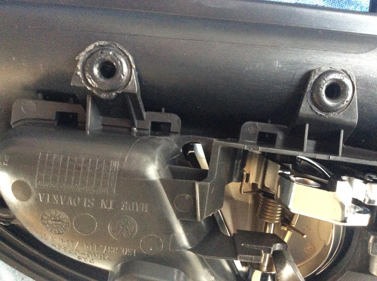

On my car, the bolts marked 3 in the link, looks like melted plastic??
Look like rivets.
I've drilled the rivets, and now have two handles ready for mounting.. But how the heck am I supposed to mount them in my car.. I guess I can't get plastic rivets and mount them the same way?? I'm thinking some industrial strength glue perhaps... What do you guys think??
Google Clinch Nuts. They might be the answer.
