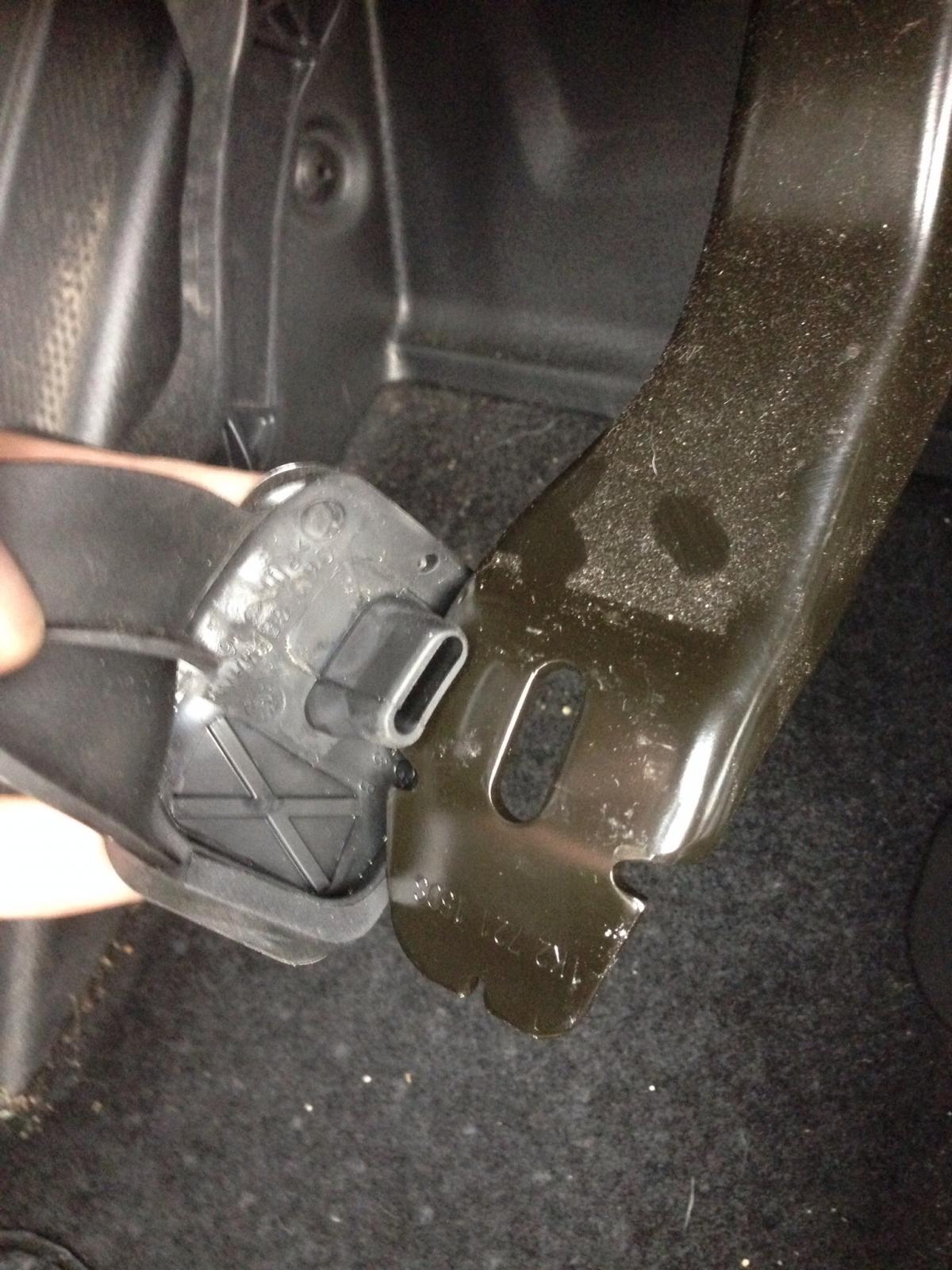

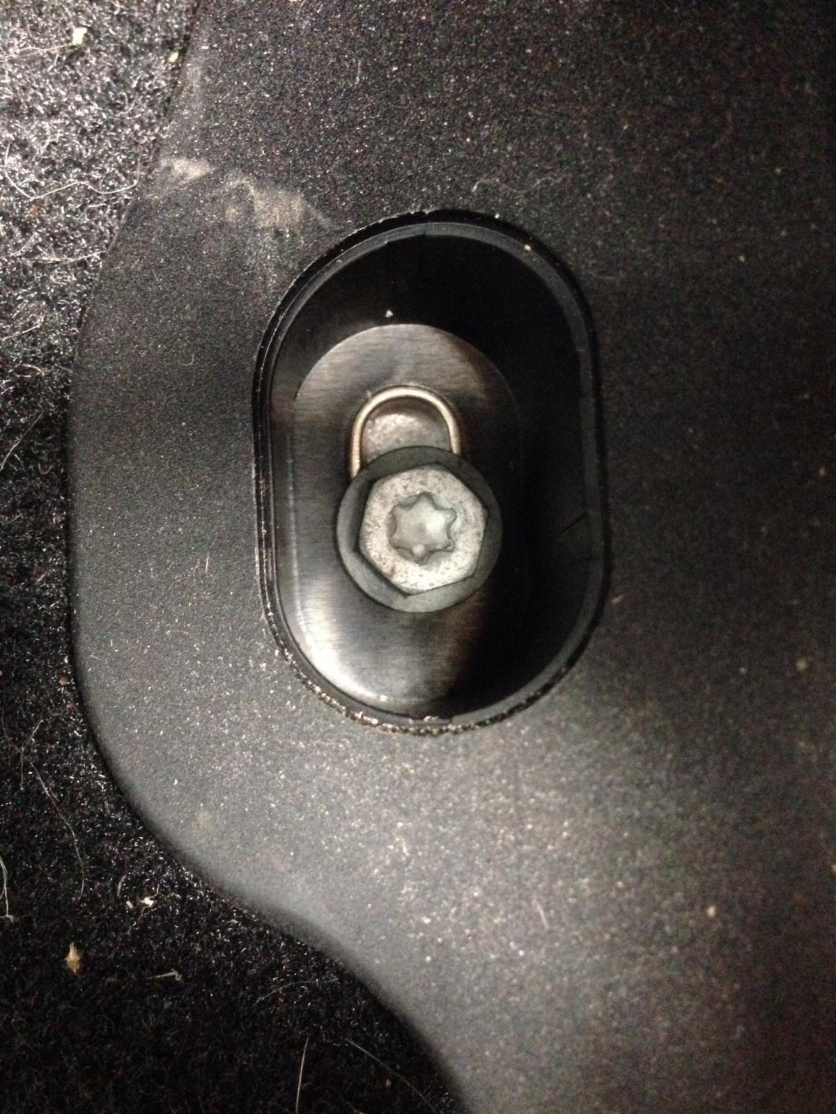

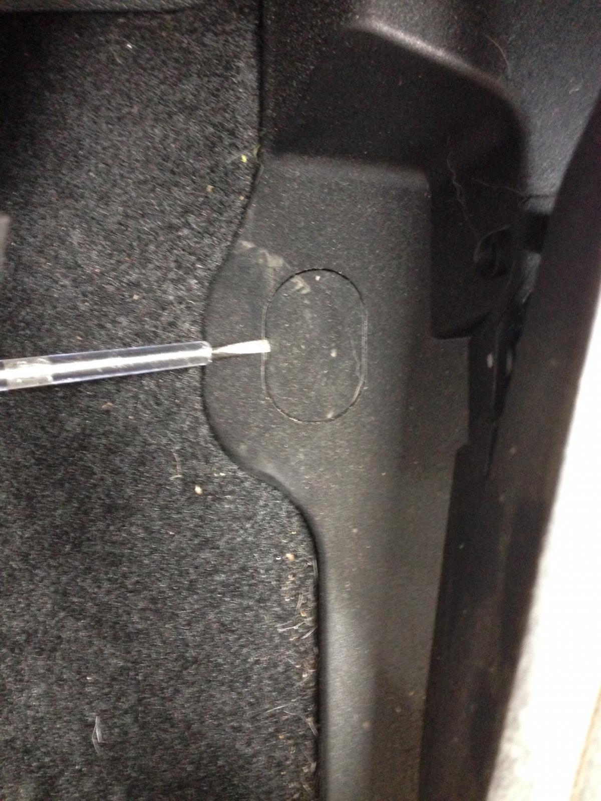

Use a small screwdriver to pop out the cover for the single torque bolt holding the top of the pedal, then remove with a T30 torque driver.
post-120571-0-02896000-1409933177_thumb.jpgpost-120571-0-02470800-1409933278_thumb.jpg

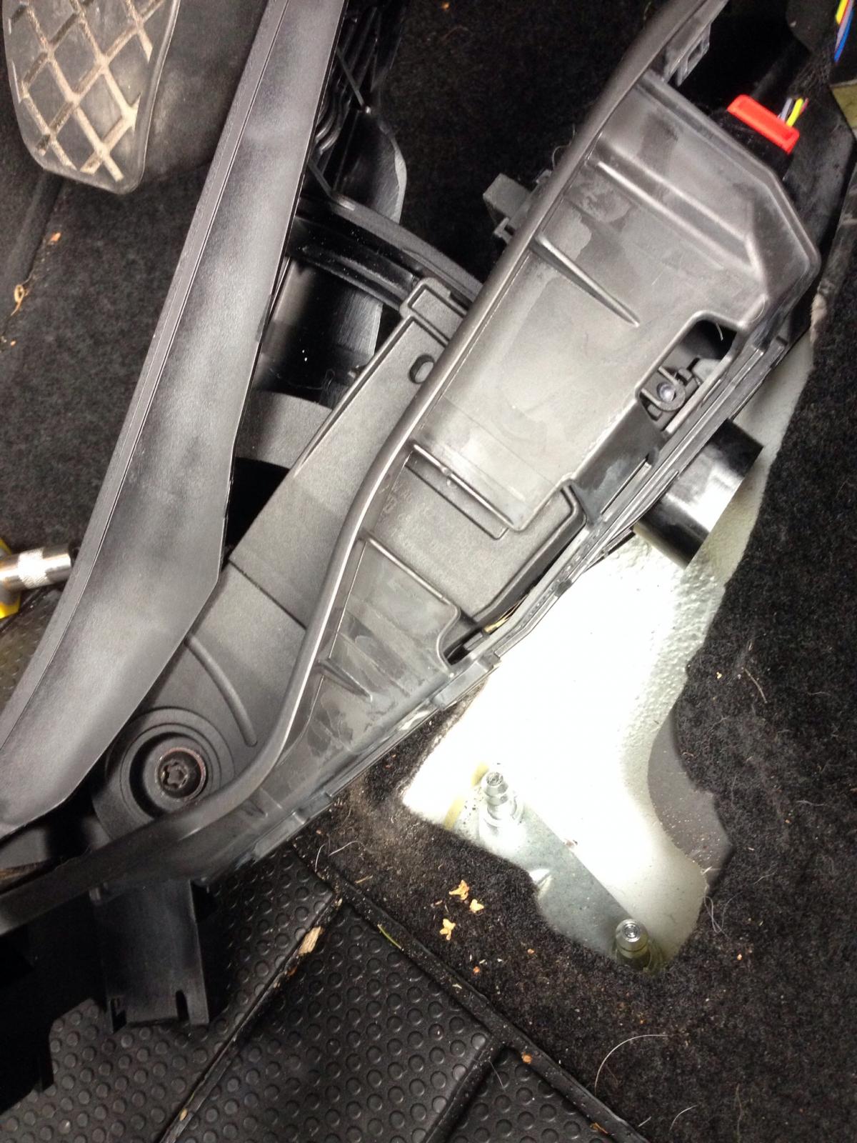

Next, unclip the bottom section, for the right hand clip, slide a small screwdriver underneath to release the clasp and pull up. The left hand clip can be released with a firm pull, being careful not to tug on the electrics at the top of the pedal. Here it is removed and you can see the two locator bolts it clips to at the bottom.

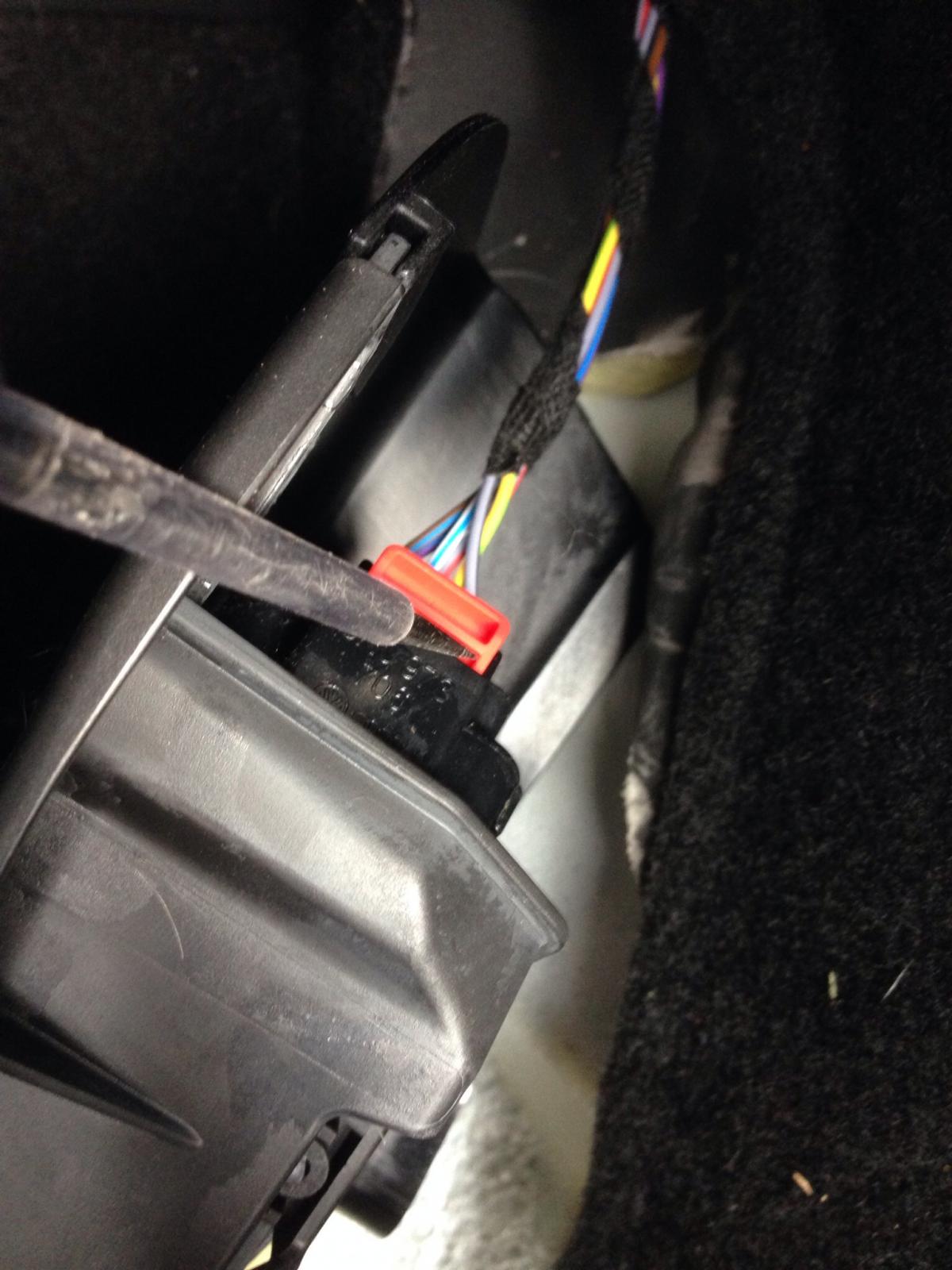

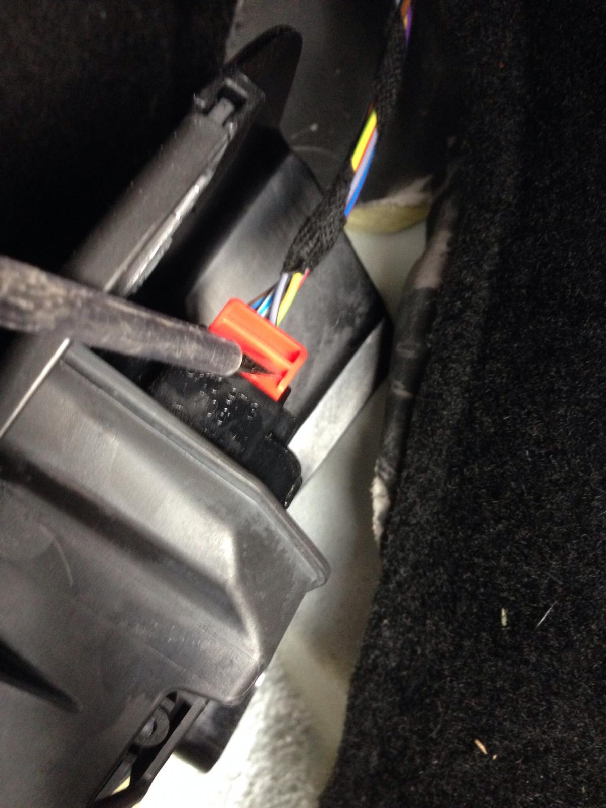

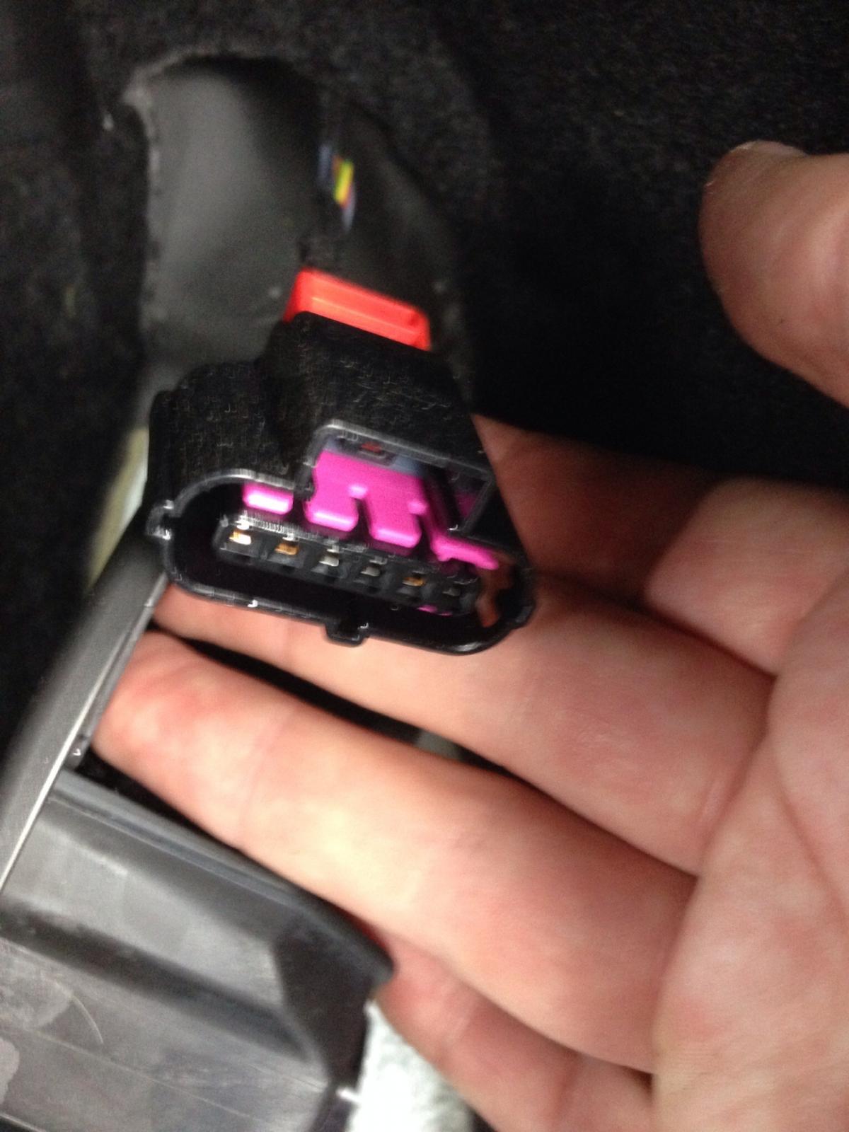

Next remove the electrical connector, use a small screwdriver to pop up the retaining clip and simply pull out.
post-120571-0-49679100-1409933724_thumb.jpgpost-120571-0-80351100-1409933739_thumb.jpgpost-120571-0-42641600-1409933759_thumb.jpg
Clip the electrics into the new pedal, remembering the locking clip. Then clip the bottom of the pedal to the locating bolts, secure the torque screw, not forgetting the plastic cover and it's all done.

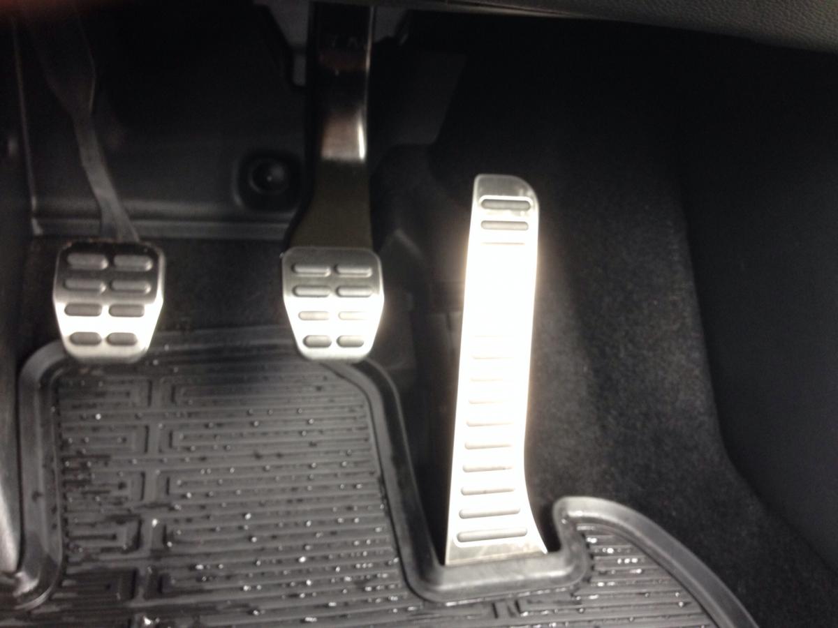

post-120571-0-12361200-1409934032_thumb.jpgpost-120571-0-88511500-1409934092_thumb.jpg
Then your all done :)
