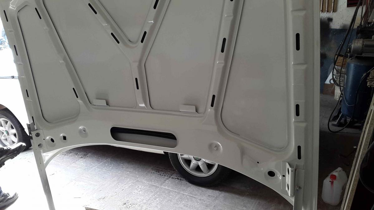

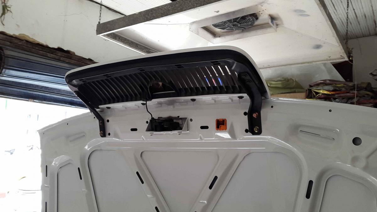

Finally I managed to find a donor for my project, This is the paint work of the bonet:
