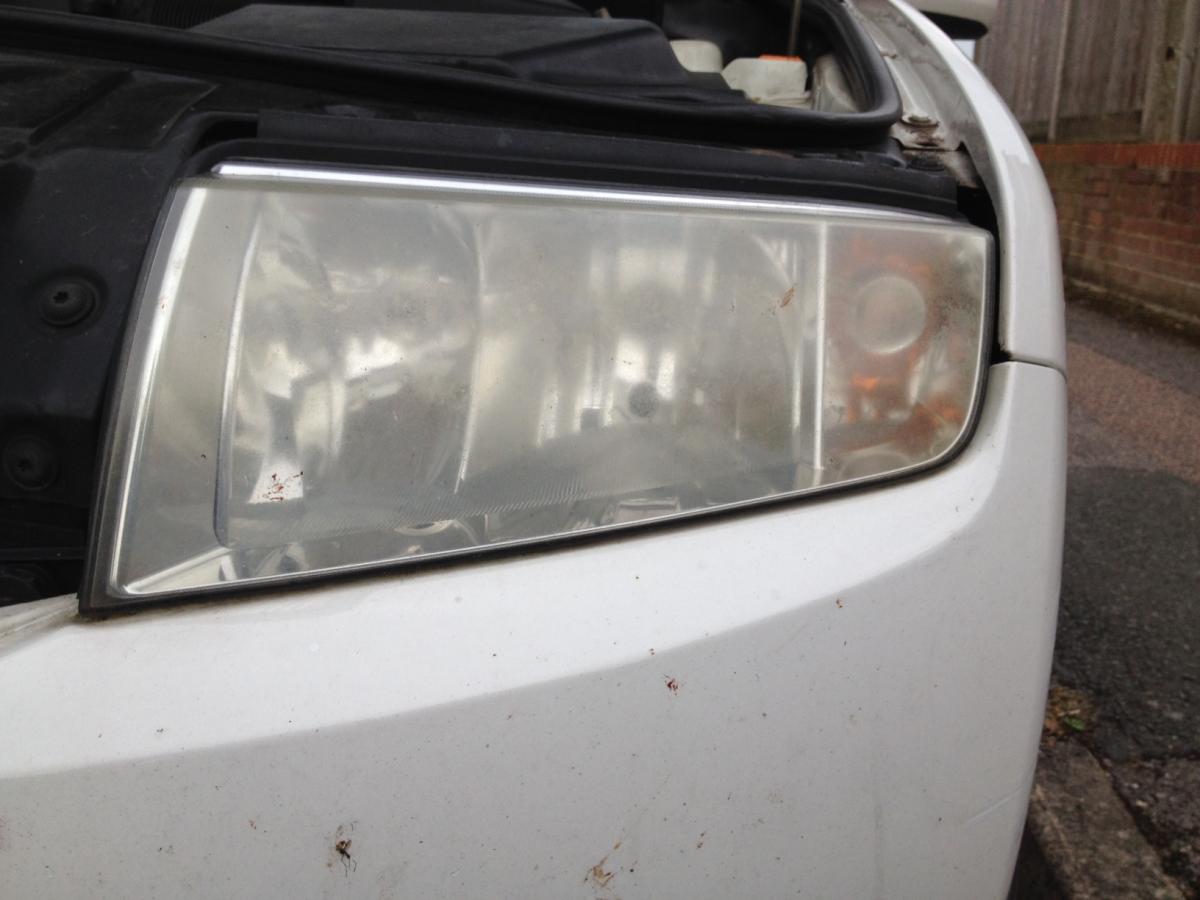

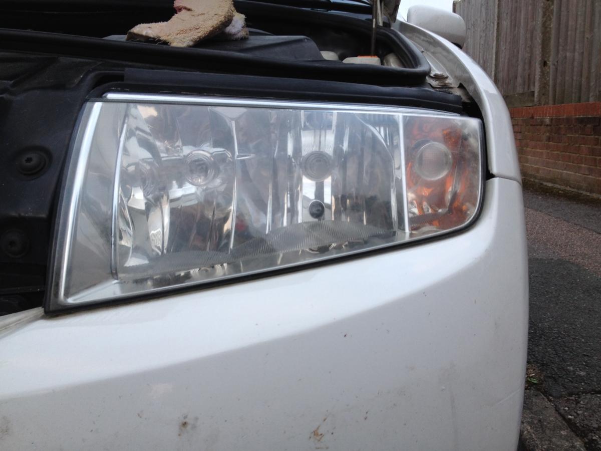

Quick post to show the success I had with cleaning up the headlights on the Fabia. I'd been meaning to do this job for a while, but hadn't got round to it.
An hour and a half for both headlamps and a fair amount of elbow grease. Job would have been much easier with one of those drill mounted buffer pads!
First started with bodywork rubbing compound on a bit of old towel, but it wasn't quick abrasive enough. Ended up dry sanding the whole lens with P1200 wet and dry, and then finishing with the rubbing compound, and thoroughly pleased with how it's come out with so little work. If I'd just gone straight for the wet and dry, could have had the job done in under an hour.
Ideally, both will need going over again as I only had half a sheet of P1200 left and it clogs very quickly, but please with the outcome for now.
