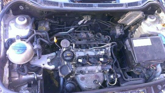

I'm sure I'm being a total muppet but where is the fuel filter on my 2005 1.2? Can't see it at all...
Underneath the car near the fuel tank is the 'normal' location for an external filter on a petrol.

Yep, look just ahead of the offside rear wheel, just in from the sill.
Ah ok thanks. On all the pictures I've found of other cars it's been in the bonnet.
It is under the bonnet on TDIs, behind the drivers headlight.
