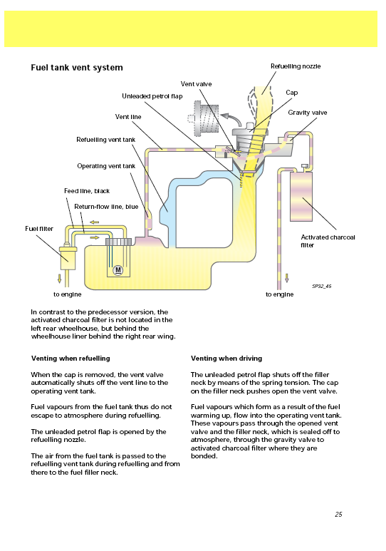

Could someone possibly explain the layout of the tank and expansion chamber and how they are connected? I had no idea that this chamber existed.

http://vwts.ru/vw_doc2/fabia_eng.pdf page 24 shows useful diagram.

I havent got a diagram as such, and i cant read Russian so i cant navigate the above website haha.
I can only assume its a small tank linked to the main tank which catches air as you fill up. As air can be compressed and a liquid cant, it would take up the extra volume as the fuel expands due to temps.
When you pull the little switch in the nozzle, it lets the air out, so you can replace it with extra fuel
This is why its not advised to fill the expansion tank unless doing a long trip.
I can only think thats how it works, but i may be wrong. Others might know better :)
If you use Chrome Google will kindly translate it for you - I managed to find the PDF and downloaded it, very informative it is too so thanks to Smittjo. Unfortunately due to the 2MB limit on attaching files can't upload it, moreover it is password protected so can't extract required pages have, hopefully attached a screenshot of the relevant page.
Edit failed miserably - will try again
Edited by adagio
Somehow managed to post twice - sorry
Edited by adagio
If you use Chrome Google will kindly translate it for you - I managed to find the PDF and downloaded it, very informative it is too so thanks to Smittjo. Unfortunately due to the 2MB limit on attaching files can't upload it, moreover it is password protected so can't extract required pages have, hopefully attached a screenshot of the relevant page. fueltankvent.png

Not seen that before. Cheers!
Very interesting :).
