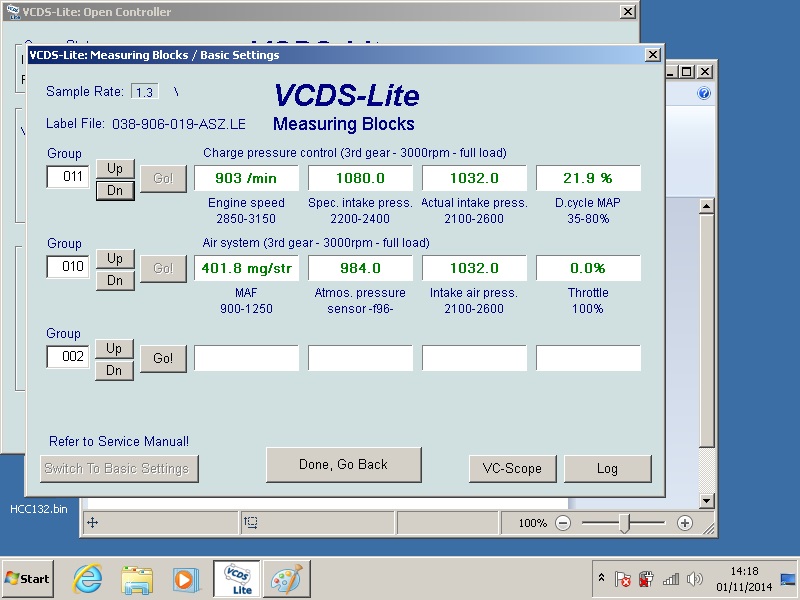

I would suggest the actuator / VNT isn't setup right on the turbo - especially if a recon.  The turbo is probably not "closed" enough at low revs to generate the necessary low down power, but is working fine at the top-end.
A log of group 11 in the engine module on VCDS would highlight this.  A large gap between requested and specified at low revs, and also a poor duty cycle.

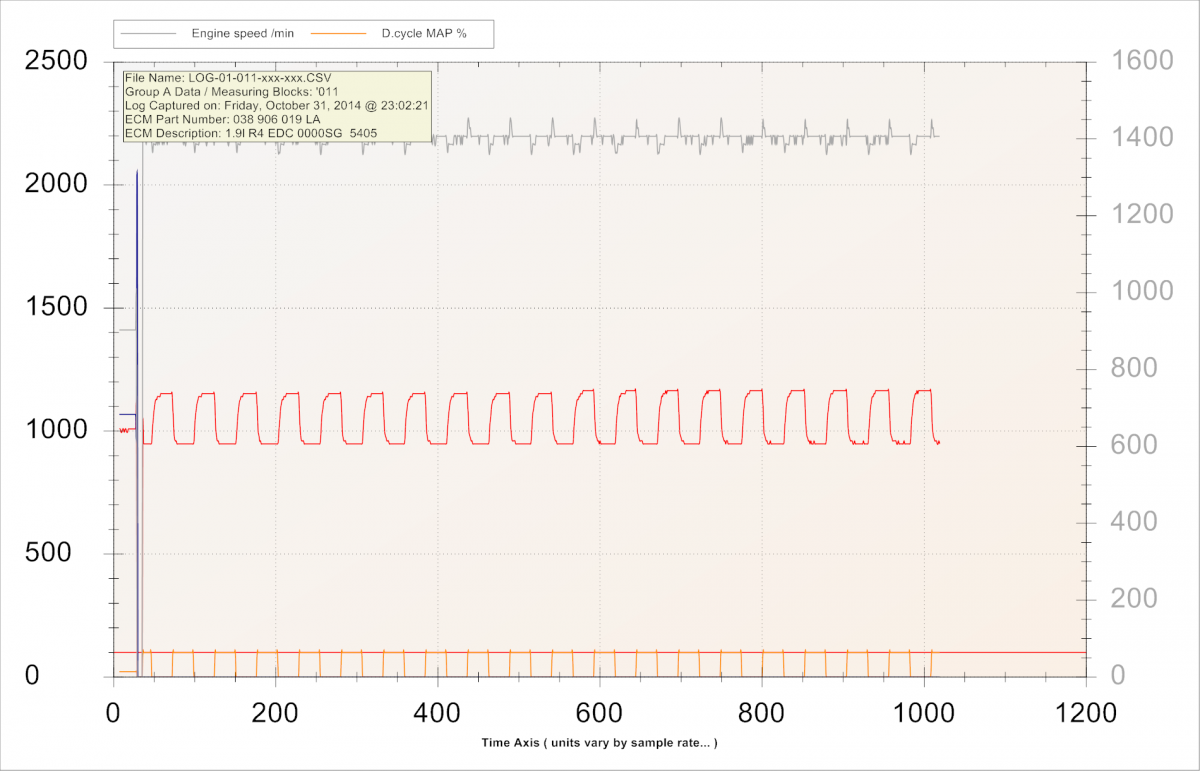

Logs are needed. Group 11 from 1500rpm to 4500rpm at wide open throttle in 3rd.
To check the stop screw you need the licensed version of VCDS lite. For this go into engine ecu then basic settings. Choose group 11 and go. Rpm will increase to 1400rpm then the actuator will go from open to closed. Log this. In the log look at the actual pressure when opened and again at closed and measure the difference. Stock turbo is around 120-150mbar difference. GTB turbos around 90mbar.

does everything look normal?

Saturday 1 November 2014 14:08:20
038 906 019 LA 1.9l R4 EDC 0000SG  5405
Group A: '011 Group B: Not Running Group C: Not Running
Engine speed Spec. intake press. Actual intake press. D.cycle MAP
TIME 2850-3150 2200-2400 2100-2600 35-80% TIME TIME
Marker STAMP /min % STAMP STAMP
0.01 1407 OFF 948 99.6
