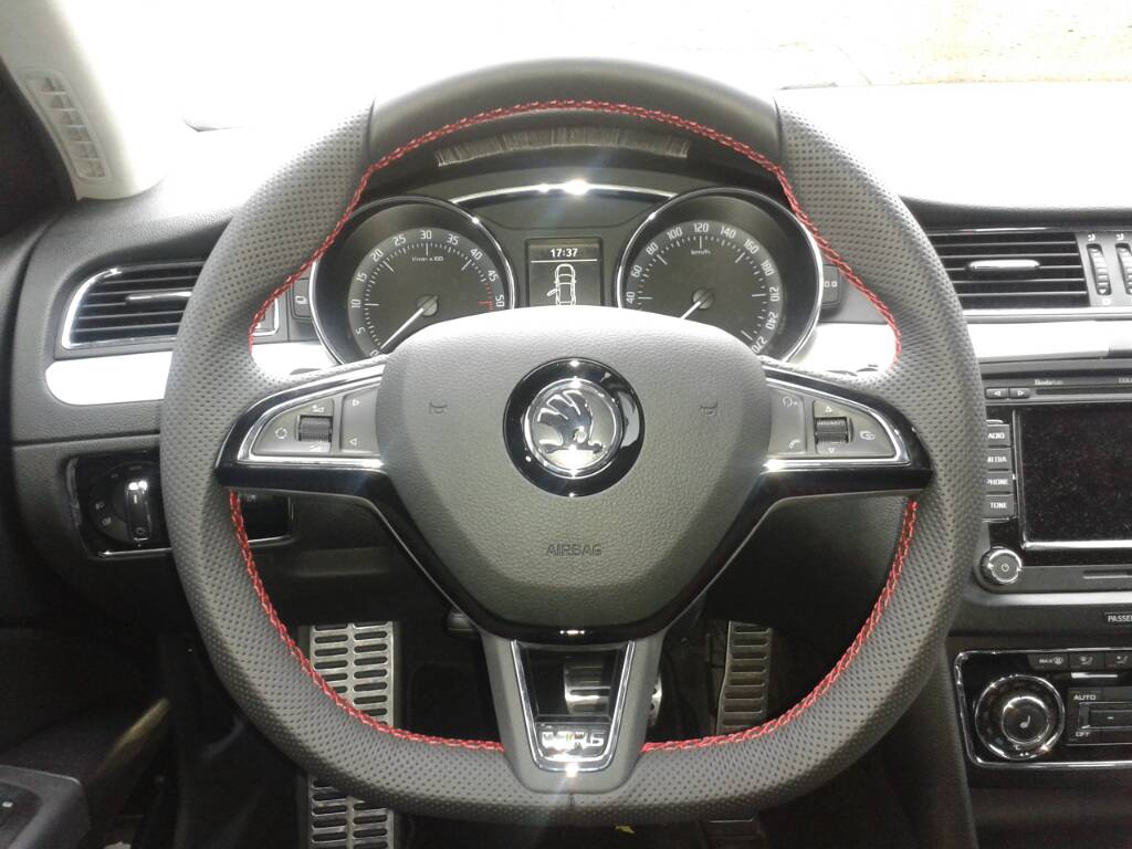

Did ours in SuperB (MY 2010)...look&feel&working perfect ;)
