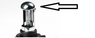

Hello i have xenon lights, not factory fit so doesnt self level etc, right side is a bit high.
Anyone know if these can b adjusted at the headlight n how?
sounds silly but check the end off the bulb, there is a chrome dome over the end of them and I had the same problem turned out to be the dome was sitting incorrectly
