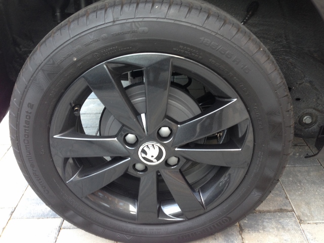

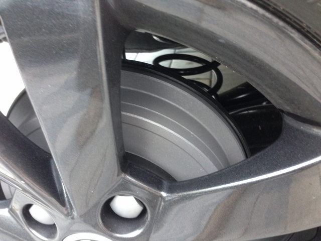

After receiving delivery of my Black Edition a few weeks ago, I have asked myself, "who on earth decided to paint the drums in grey primer?"

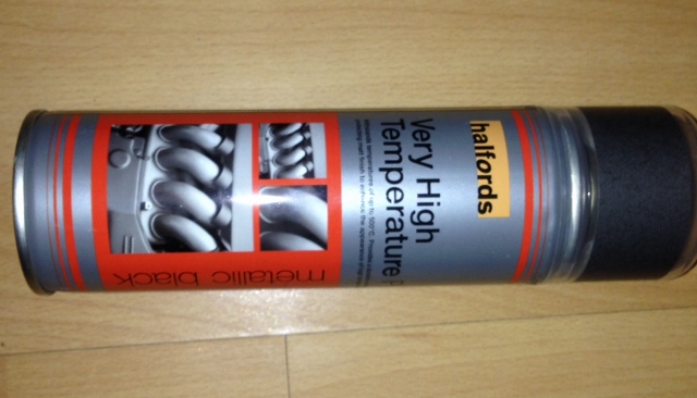

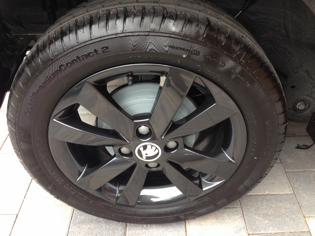

So I got fed up of looking at them, I bought a tin of Halfords VHT Metallic Black paint and set to them.
As it only requires to removal of the wheel and a T30 bolt, it is a simple task (Be aware, to remove the drum, the handbrake will have to be released. Ensure that the vehicle wheels are chocked to prevent the car moving and falling off the jack). When off, it was evident that rust was setting in, some ten minutes of effort with some Scotch Brite, and a few coats of paint, a contrasting result!

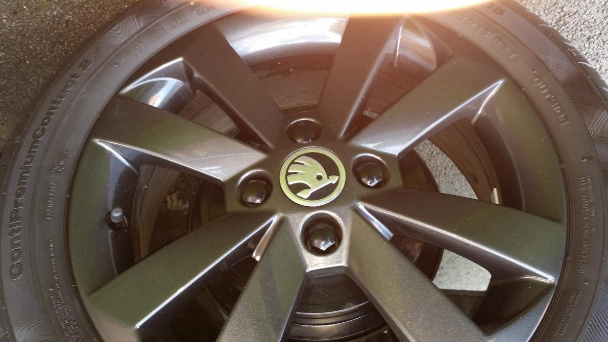

I thought the grey drums and silver/grey wheel bolt covers looked bloody awful. I used a gloss black paint for the drums and got some gloss black wheel bolt covers for the wheels. Couldn't get the gloss ones for the locking wheel nuts so got four Matt black ones from an Audi dealer and got some 3m gloss vinyl wrap off eBay for £1.99 and covered the covers with wrap. Matches perfectly and no grey just black .
