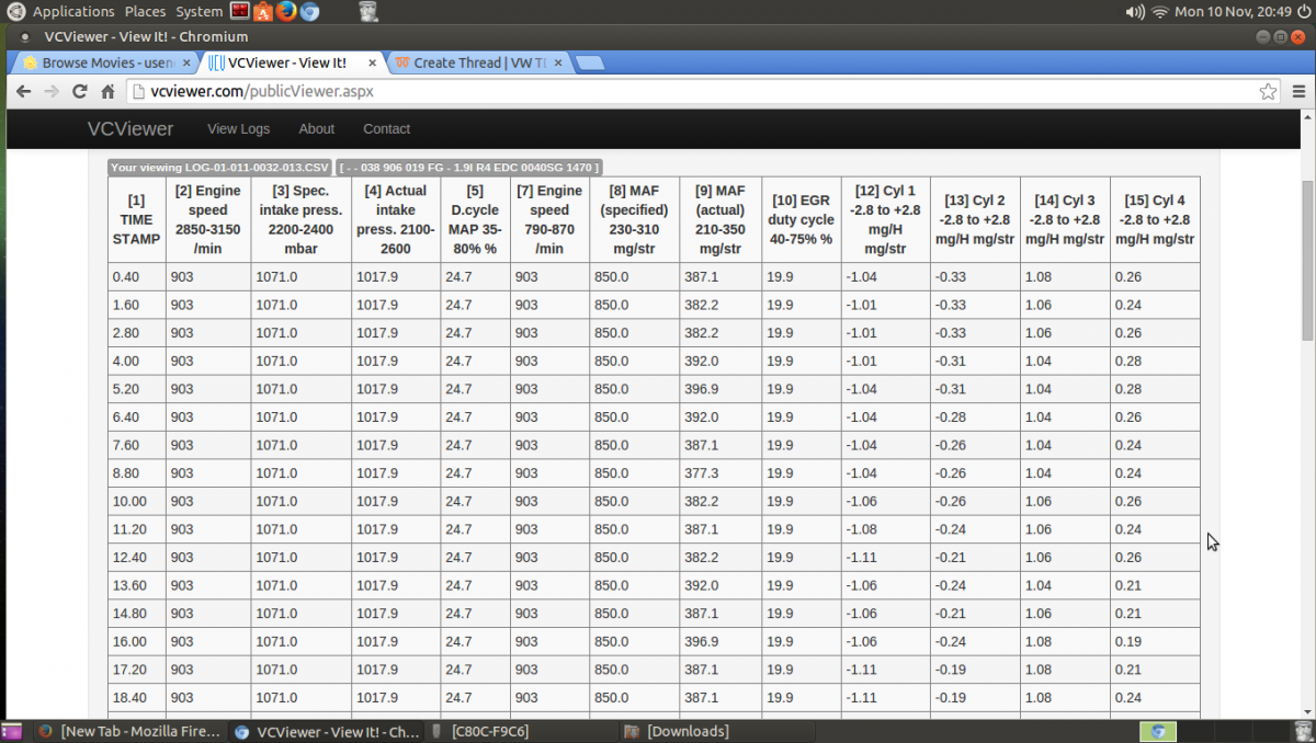

if i'm correct as shown in the log below, it shows injectors 1-3 different from the other two. would this indicate that injectors 1-3 would be the two injectors what are incorrectly torqued, closest to the sprocket?
firing order 1-3-4-2  as vcds shows just 1,2,3,4 and not 1,3,4,2
well after messing about with my wine configuration i finally got autodata working in linux   :D
so does this confirm 1-3 are closest to the timing belt?
thanks
Yes.
