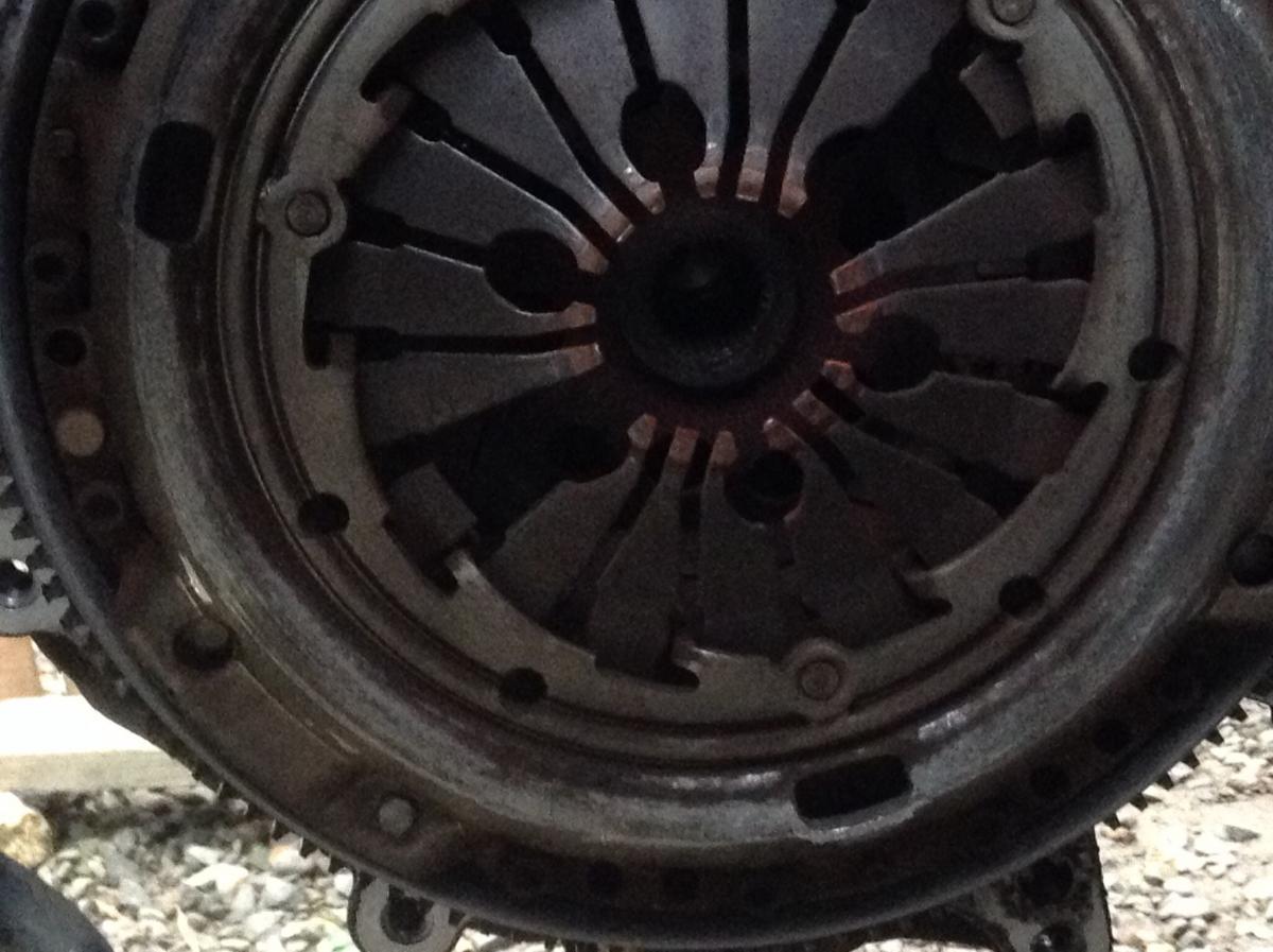

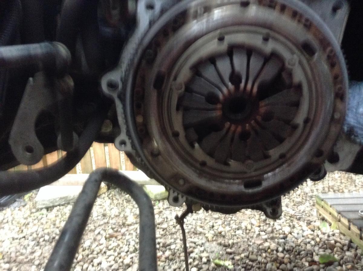

hi all have just dropped gear box out to find the clutch cover missing some of the fork thing so do I go dmf or smf any help appreciated
Stuart
That is normal on a DMF clutch cover. If you look at what is there of the forks that are missing, they have not snapped... its manufactured that way.

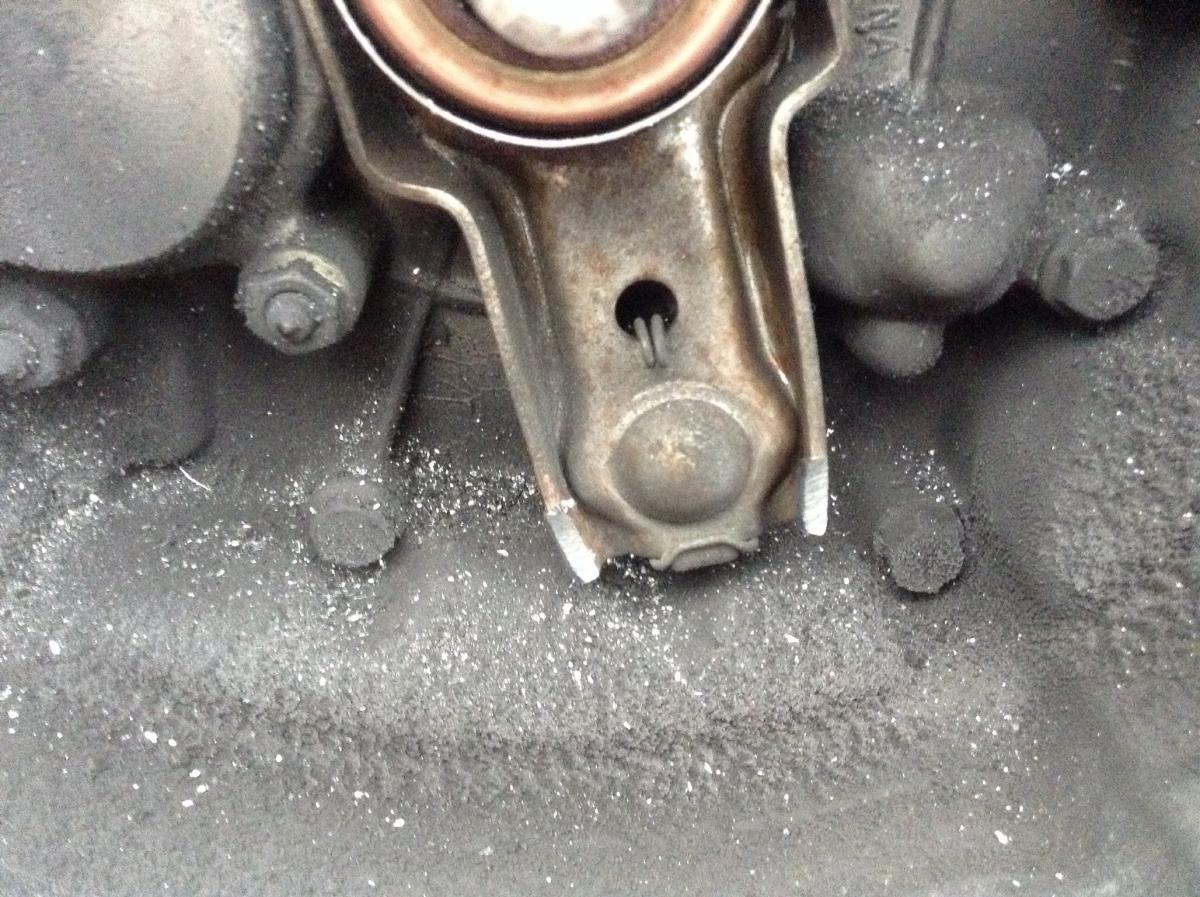

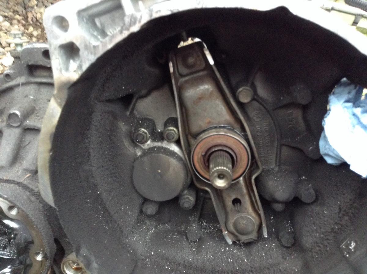

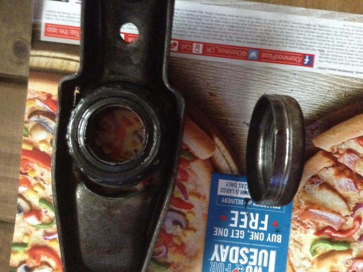

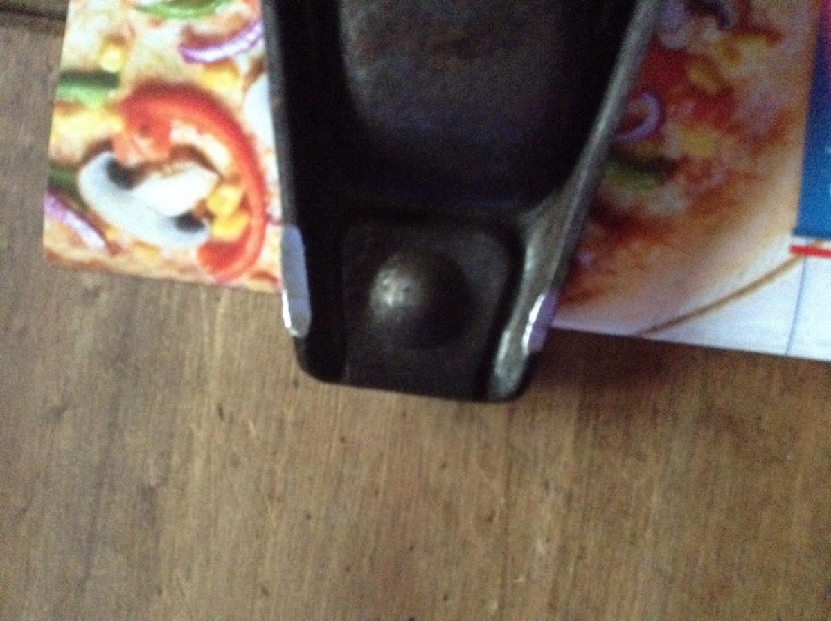

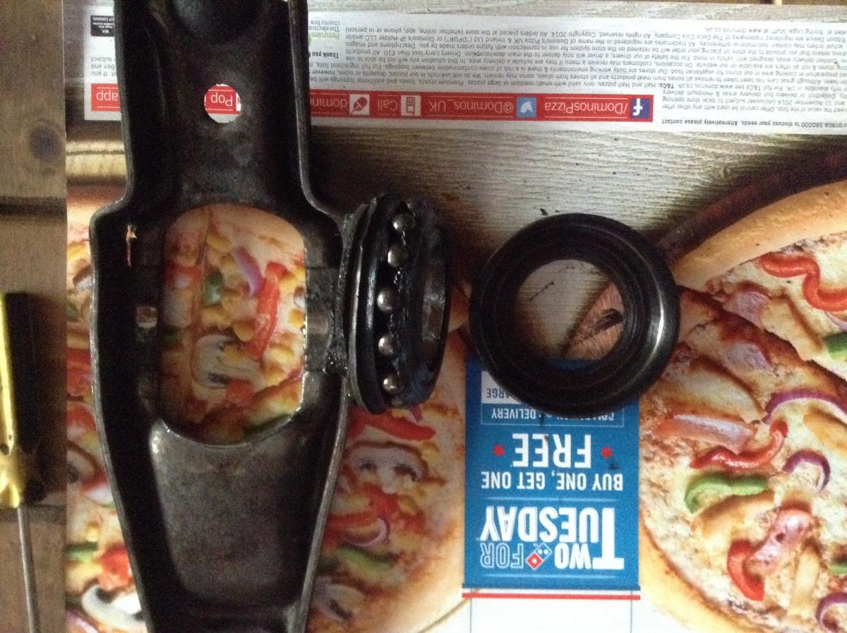

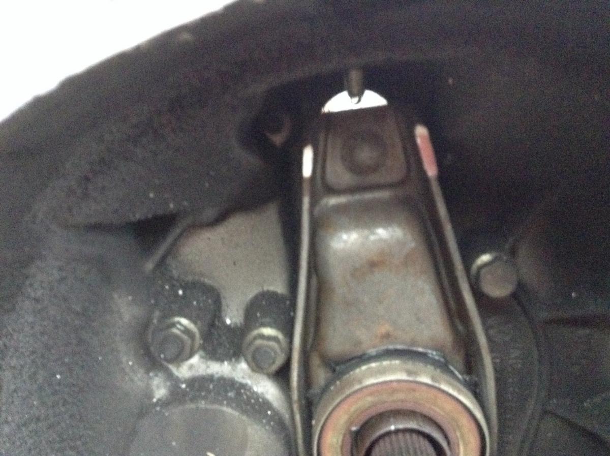

I took the gear box out today the fork for the release bearing has damage at the top and bottom of it you can see it in the pictures and there is metal bits in the gear box housing have not check it yet .back a bit sore just now
that lever with wear should be fine when u put new clutch in. check that the lever pivotsokay on the ball pivot.

will have a look tomorrow you can see damage on the release bearing fork any way of checking the slave cylinder

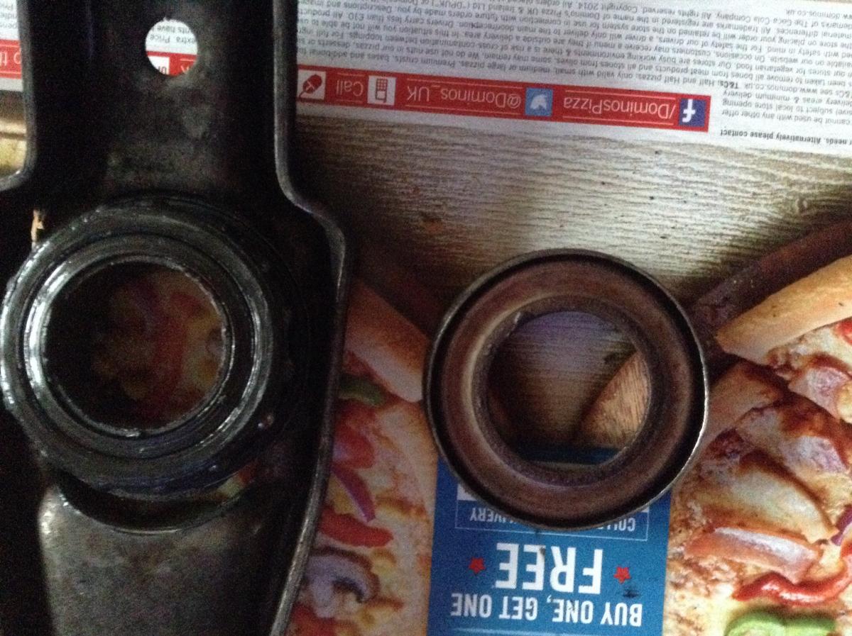

so just been out to check the master and slave cylinder for leaks all clear as far as I can see,then went to check the release bearing and fork the cover of the bearing just came right off so could this be the problem any thoughts cheers

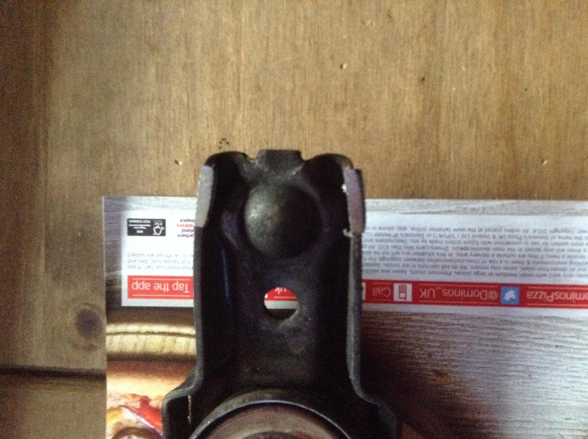

hi just been out check the release bearing fork going to have to get a new one just noticed it has cracks in it clutch seems ok so going to change just the bearing and fork see how it go's

just a wee update new release bearing and fork fitted job was not as hard as I thought it would be ,only a couple things I had to do before starting the job .i had to make my own engine brase I used cargo straps to hold the engine in place and to hold the gear box could not use my trolly jack to lift the gearbox up because my driveway has small stones on it,only other problem I had was when the gearbox was being pulled up it kept catching on where the wish bones connect to the subframe so after a bit heed scratching thought if I turn the box so the axle flanges where pointing up slide the box in then turn it to right that way the axle flanges are sitting above the subframe so all done clutch feels good

looking on the pressure plate,I bet you have a DMF ,if still asking
the model with the missing tooth is for DMF
and the fork is bend,that;s why is rubbing on the pressure plate,in case if you still wondering.... :)

thanks for that yip I have dmf clutch the old fork was cracked and chipped as we'll so new bearing and fork everything feels ok now
