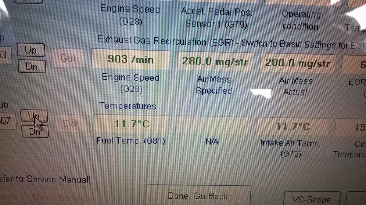

Had my first good look at it today I think it could be the maf it seems to run better with it unplugged and it don't mis as it has been you plug it in and it starts what reading should you get off a good maf on tick over

If it drives better with the MAF disconnected, then that's a strong suspect regardless of fault codes or data from idle.

Heres mine stone cold this morning flicks up and down between 275-285
