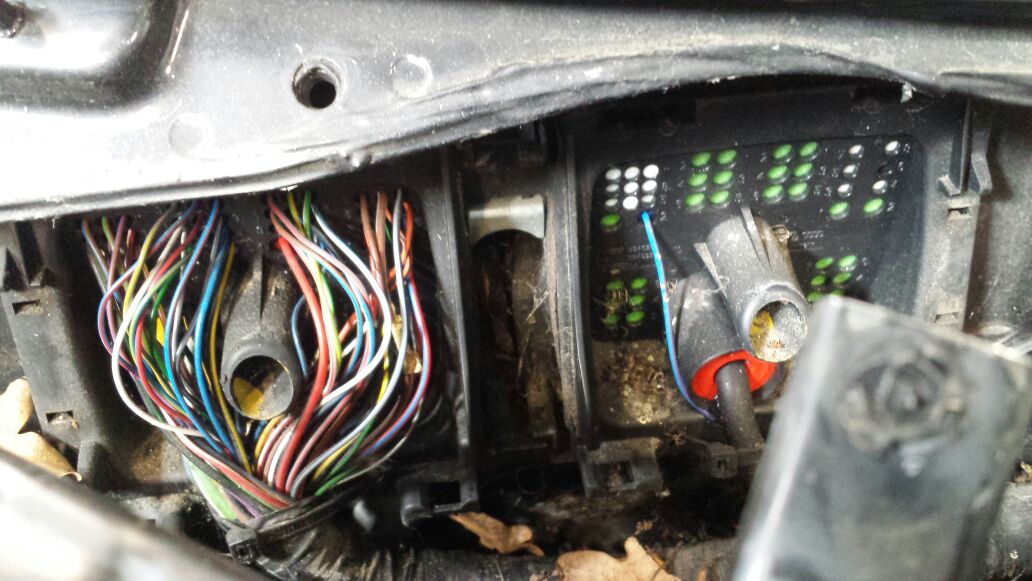

Hi Danny, techie
Ive been asked if I can find out which pin it goes into.
Attached is a pic of the ecu wiring.
If I can guide him through this helpful and delightful forum, I could have cruise on my fabia finally! !!
Help most appreciated gents.
White wire on engine ecu pin 15 of the larger plug.
Hi techie
Been told the following-
Pin 14 - white wire
Pin 15 - grey/yellow stripe
Pin 16 - grey/white stripe
Safe to assume it is pin location 14?
Best
Adil
It's the only single white solid wire that you want.
Sorry pin 14. The wire is on its own, been a long time since I had to know the PIN number, I just know the wire.
