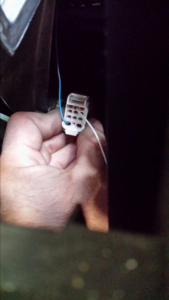

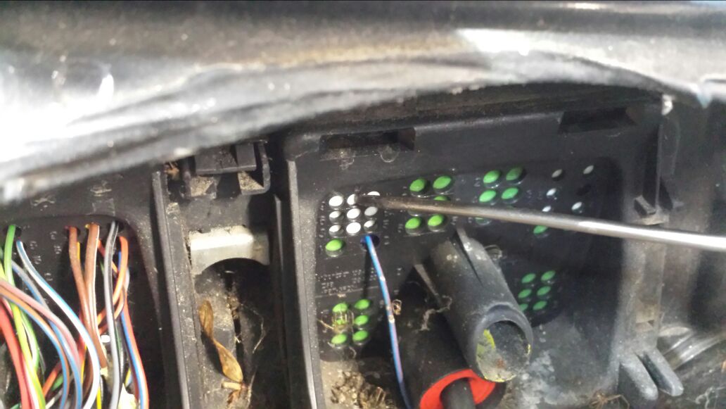

Hi all
Having my cruise fitted and ran into an issue.
Seems there is a wire missing from the plug in this photo (screwdriver pointing it out).
Are we missing something, or is the wire elsewhere?
Yup the white signal wire moves about depending on age. It always ends up at the ECU though which is why for the many many many I have installed I go straight to the ECU. Plus that connection point is a known source of connection issues,
