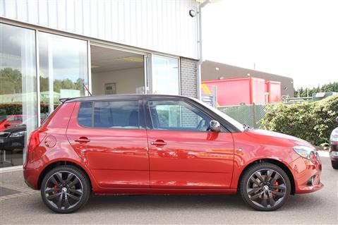

First picture is the 2011 model VRS

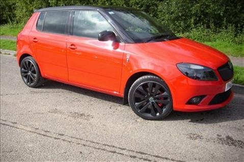

while the second picture is a 2014 model vrs
i seem to notice a colour shade change? are skoda not using the standard red on post 2011 cars ? as i prefer the 2011 model

First on the Colours.
The Rio Red is Metallic. & a recent option.
Solid Red has been available 2010- 2014 'Corrida Red'.
Rio Red late 2013-2014
(maybe not many Solid Red vRS around in the last 2 years because people did not buy that colour,
there are a few Red Estates around that were built in the past 2 years.)
