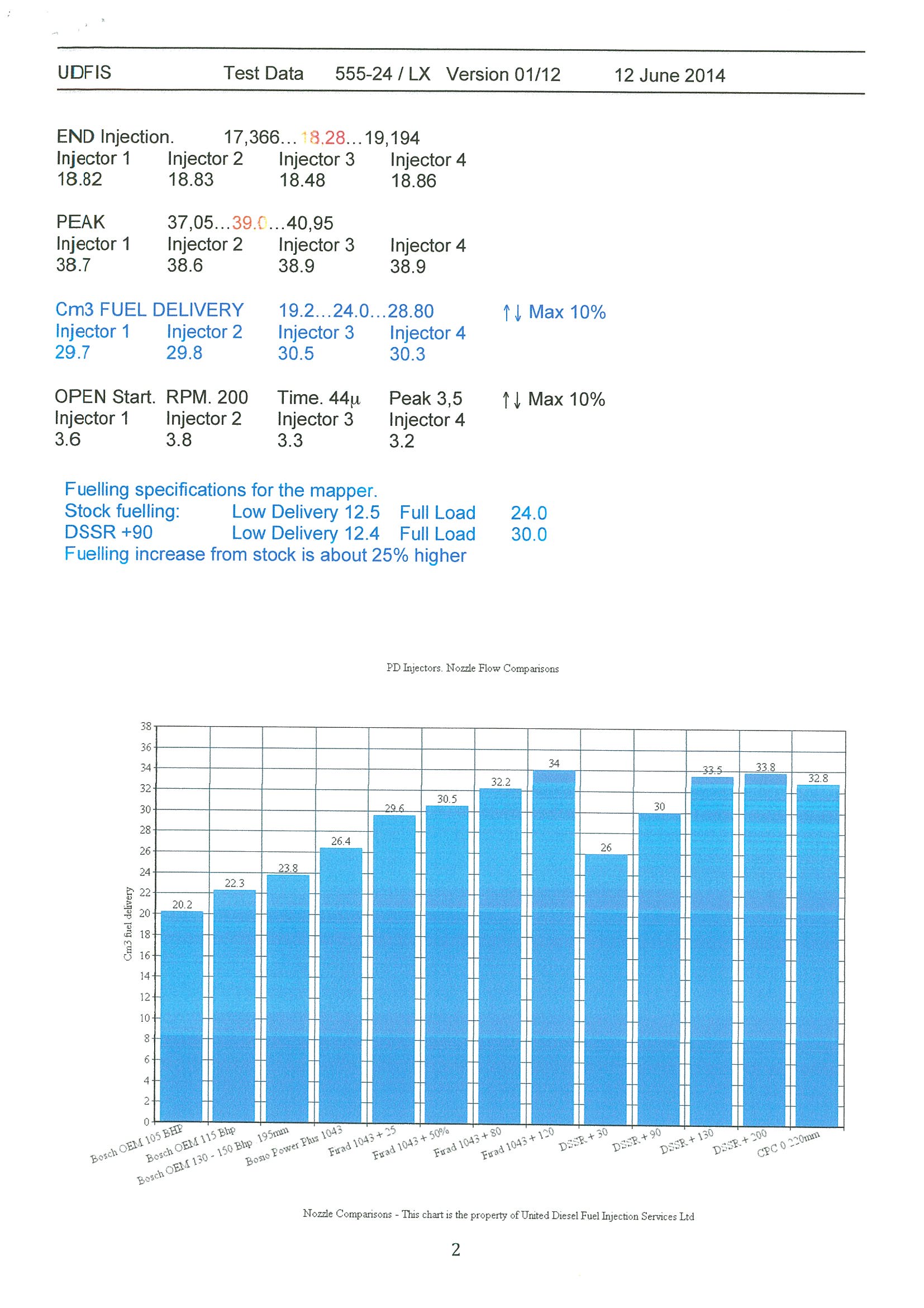

don't take the % rate as the increased flow rate thats not how it works (it looks good on advertising though) Don't know exactly how they work the % rates but
Here is the flow charts and figures from my DSSR 90% nozzles and compared with others, you can see mine flow 25% more across the whole range and have been rated to 320bhp max
Having spoken with United Diesels at great length he told he how Firad nozzle are very un-predictable and its a lottery to what they will flow when matched to good injector bodies he has seen 50% flow more than 80%
he says this is because Firad make nozzles on a huge scale for all manufactures of vehicle and 4-5 times a yr they run a batch of "uprated nozzle" eg. large nozzle holes.
whereby DSSR look at the nozzle as whole and design the uprated flow around the whole nozzle, therefor better spray and atomisation pattern and more like standard nozzle holes, this gives better low rpm control, better cold start & longer life span.
I'm not knocking Fiards nozzles many many people use them and they are fine, but i made my choice based on what i read/told and DSSR/DSR track record success (oh they were cheaper as well) and i believe United Diesel is the UK supplier of DSSR nozzles???
Also having spoken to other peeps who have had the cars mapped by other tuners on DSSR's they are preferred by the tuners over Firads and are easier to map and to get good clean results
