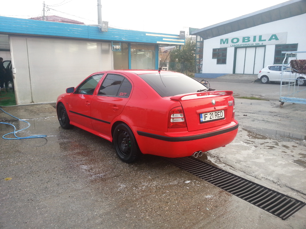

Just finished my exhaust mod and wanted to show you guys a sample of it.
Removed the final exhaust piece, replaced with stainless stell pipe and added a Magnaflow Y tips to it.
The pipe stretches from the intermediate piece all the way to the back.
Here's a few pics and a video with it.

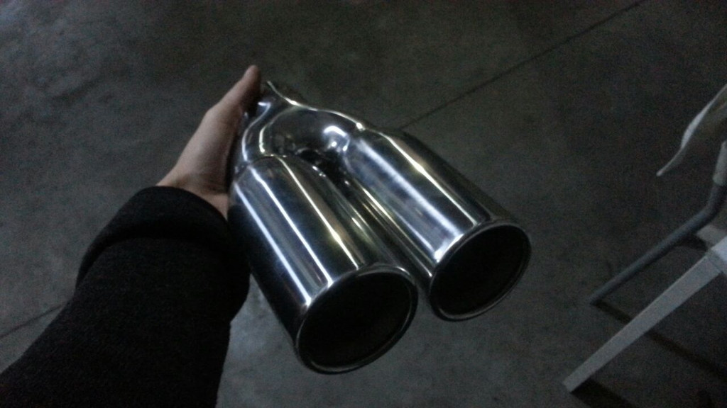

Could you weld that tip on to the the end of the octy standard exhaust obvs cutting the the original tip off?
I want this look but don't want to have to replace the full lot.
The tip is Y shaped. The standard exhaust muffler uses two pipes towards the standard tip. You must get two separate tips or modify the pipes coming out of the muffler and turn them into one for the Y tip.
Search some pictures of the standard muffler and you will understand.
Here is a better pic of the mod
Nice, neat and simple. I likey a lot!
Very nice sound and looks miles better than standard pipe.
Do you have a link to the pipes. If no do you know the sizes required.
Paul
Hi there Paul.
The pipe size is standard, no increase or decrease in size. 63mm i think it is.
Cheers mate. If you dont mind me copying do you have any links to the parts you got. Mainly the end double exhaust. Thanks again
Paul
I don't have any links because they were purchased from the garage where the mod was done. The tip is Magnaflow, the pipe is standard stainless.
