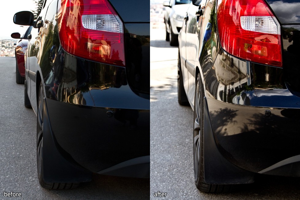

Looks much better, thinking of going 10mm front and 15mm back or similar. What about the locking wheel nut bolts, do they come in the pack with the new longer bolts?
