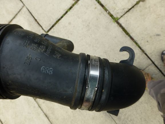

Remove T30 bolt and turn turbo inlet pipe clockwise to disconnect hook fixing at rear of pipe, P1080589(1).JPG.ee871ae1f798ab0e5ac125c0c041b4b1.JPG

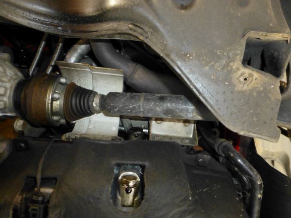

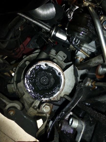

Mark the edge of the inner drive shaft CV joint for later alignment and remove the 6x M8 spine bolts and spacers I turned the Nearside roadwheel with my foot so the shaft turned to aid removal of the bolts,P1080665.JPG.f6ea577ad6b1c5b40b0f6907ff5f41e2.JPG
Remove the main wheel driveshaft nut 36mm,

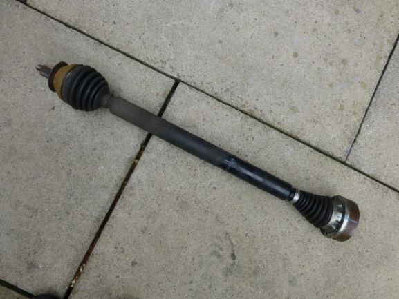

Remove the 3x 16mm nuts holding the wishbone ball joint lower fixing and push down the wishbone to allow the driveshaft to be withdrawn and removed,
Place a small plastic bag over the inner joint to cover the grease, P1080602(1).JPG.f5031b947951103c70829038ea182bea.JPG

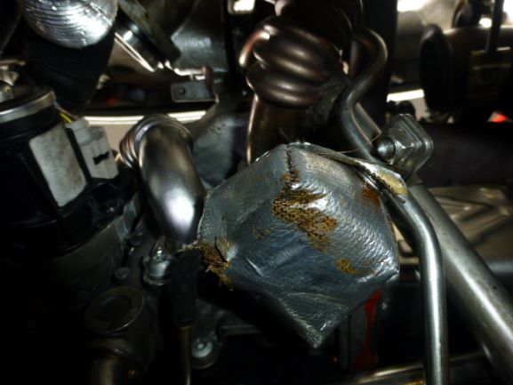

Remove the silver heat cover over the EGR air actuator, P1080657.JPG.8e70cc3a9a3dadf987e25549cdd5fd04.JPG

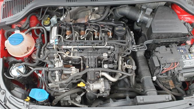

Remove the metal pipe on the battery side, 2 bolts on each joint with metal washers  (T30) top bolts accessed from above, P1080595(1).JPG.2889983940e4ed9020a4661332ae04bb.JPG
Remove the righthand metal pipe and gaskets 2x T30 on the lower and 2x 12mm nuts on the top joint which is at exhaust temperature,

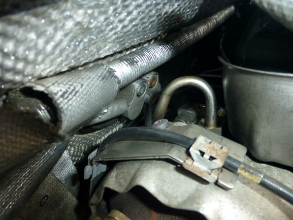

On top of turbo loosen the nut  on the small metal oil pipe using a small dumpy 17mm open ended spanner (tight space), P1080685.JPG.ca2d558e548fb20f25574b11fe14c690.JPG
Remove the oil pipe fixing bolt 13mm under the turbo and remove,
Remove the T30 bolt halfway down the metal oil pipes holding them together, P1080593(1).JPG.07b3e0d3097abd7e8b37ee5cc318ddaf.JPG
Unscrew small 'banjo' bolt (+2 metal washers) 17mm on the smaller metal oil pipe at the back of the engine and catch a small amount of oil with a rag and remove pipe up to turbo, P1080599(1).JPG.e4621074a4bbc5c5a167147abbe2a4da.JPG
Unscrew larger 'banjo' bolt 27mm on the larger oil pipe and again catch small amount of oil with a rag,
Using a couple of long extension bars from below unscrew the 2 bolts (2x T40 or 10mm) under the turbo on the larger metal oil pipe and remove pipe,

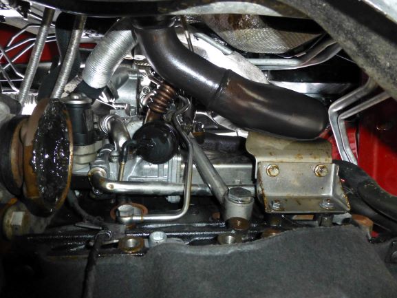

From above disconnect EGR electrical plug (can be fiddly),

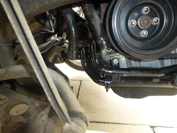

Under wheel arch disconnect with mole grips etc 2 water pipes feeding the EGR cooler with about 600ml antifreeze loss, P1080607(1).JPG.981913eec28f238d81a0747dcdc47a5e.JPG
Unplug air pipe on actuator (that had silver heat shield)

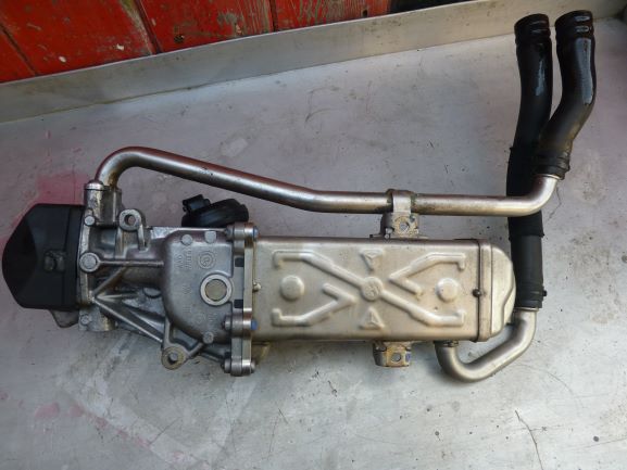

Unscrew 4x T30 bolts fixing the EGR noting the 2 longer bolts are used at the battery end and lower the EGR and cooler, feeding rubber pipes around obstacle (pic upside down), P1080619(1).JPG.4434abf67b3d0ece16b430e453cab083.JPG
The cooler splits in half after removing 6x T30 bolts, P1080633(1).JPG.4aaf4bc8ab8d9a513a10f99733dba290.JPG

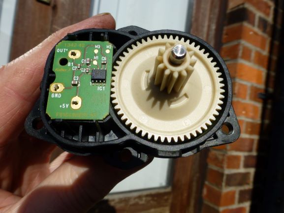

If you want to check the gears inside the EGR motor its fixed with T20 bolts. P1080638(1).JPG.1fcb2d6200b78fda2e58ecf3987e3e0e.JPG

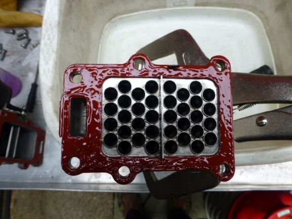

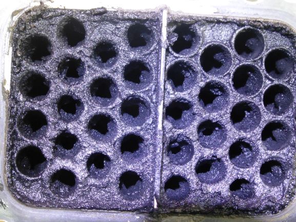

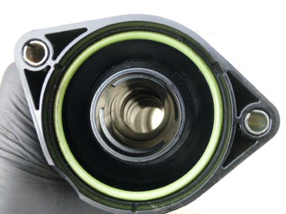

I cleaned out the heat exchanger and pipes with oven cleaner (99p 390ml from Home Bargains) and note that each 'core' of the exchanger has 3 lobes inside so I used about an 8mm brush with oven cleaner until it started coming out clear,P1080635(1).JPG.bf665258b9710ba5719a7d221960cbca.JPGP1080634(1).JPG.2acbe9376a23243fa78eaa6372d77452.JPG

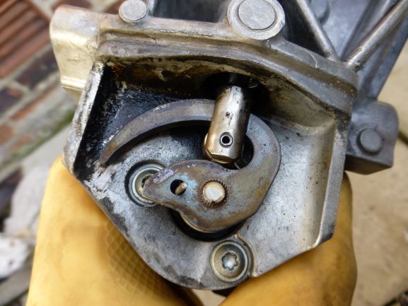

There is a black plastic cover on one end of the EGR covering a cam that needed cleaning and oiling (note I had to refix it back in place with a bit of silicon), P1080643(1).JPG.13d51f84603575be54fb133503f27721.JPG
I jammed open the EGR motor spring loaded cam inside with a red plastic rawlplug so I could clean the actuator piston on the other side, P1080640(1).JPG.a859318b4ff6f5587694a6d677b14307.JPG
I used some 'red' hermetite gasket seal when joining the cooler back together, P1080647.JPG.d30cbd37fd3992b7f0bd7ee9420deb0f.JPG

When replacing the driveshaft there is a rubber gasket on the inner joint which I transferred to the driveshaft and inserted the bolts through to hold the gasket in place and then using 2 or 3 extension bars from the wheel arch I could press the 6x M8 spline bolts into place after lining up the shaft marking,

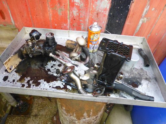

Its a nice dirty job as you can see, so the next job is to fit an oil crankcase catch can if I can find room in the engine bay.
