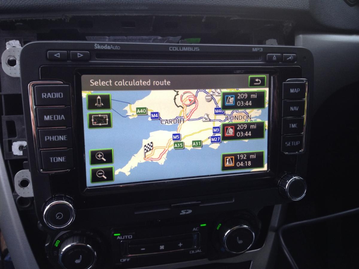

First up was to swap the head units, investigate what goes where, how much space was available for access, etc. and add the MDI functionality. I'll add more information here when I get around to doing the rest of the jobs.

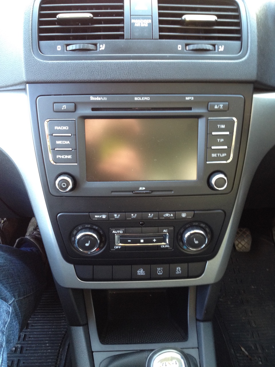

So this is how it looked yesterday morning - pretty standard for a 2010 Yeti:

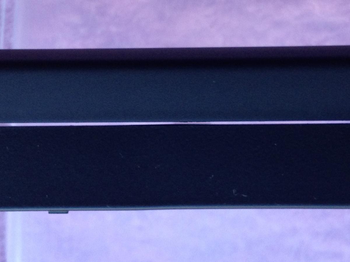

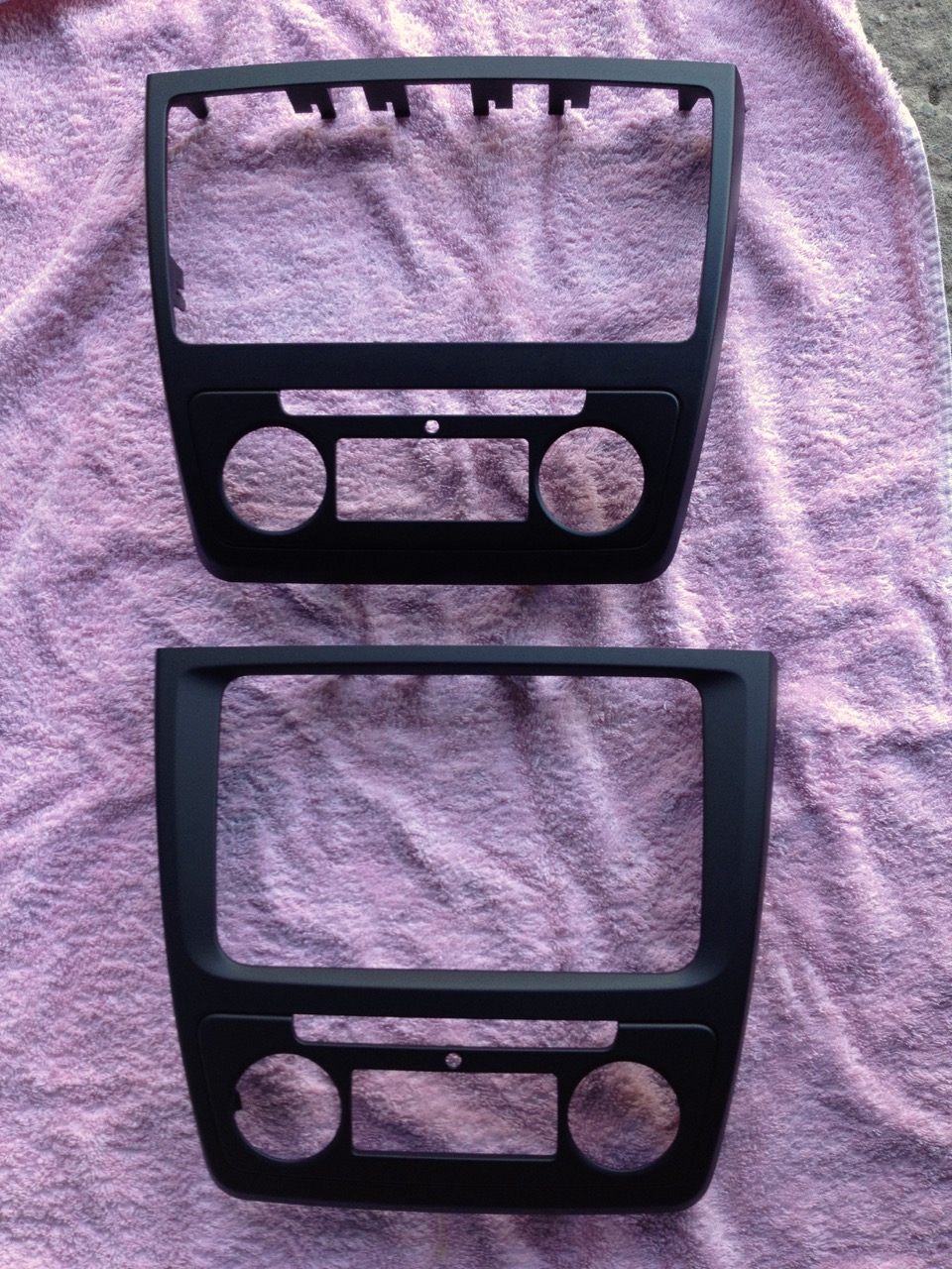

Fascia arrived courtesy of Skodateile (p/n: 5L0 858 069 L 1QB) and that's where I noticed the first slight variation in colour to the original trim. This is what they look like from a distance (Bolero fascia at the top);
The eagle eyed amongst you may just notice a slight difference in surface finish. The Columbus fascia is a 'satin' finish. I need to check the Bolero surround part number to see what finish that was. this close up may just show the difference (again Bolero fascia at the top):
Now it's finished, it looks good finished until you look very closely at the rest of the dash trim (around the dash top box for example), then you notice the slightly shiner plastic there.

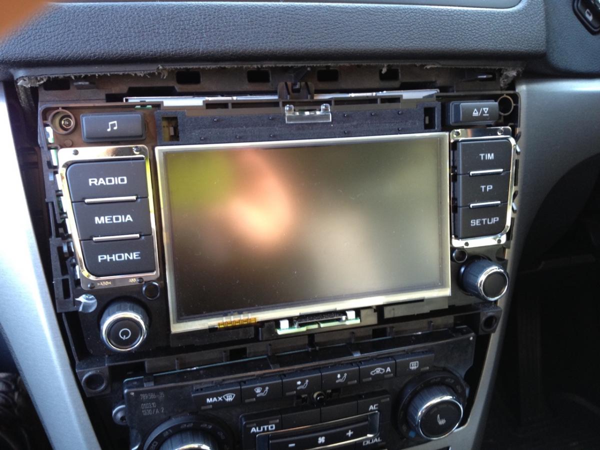

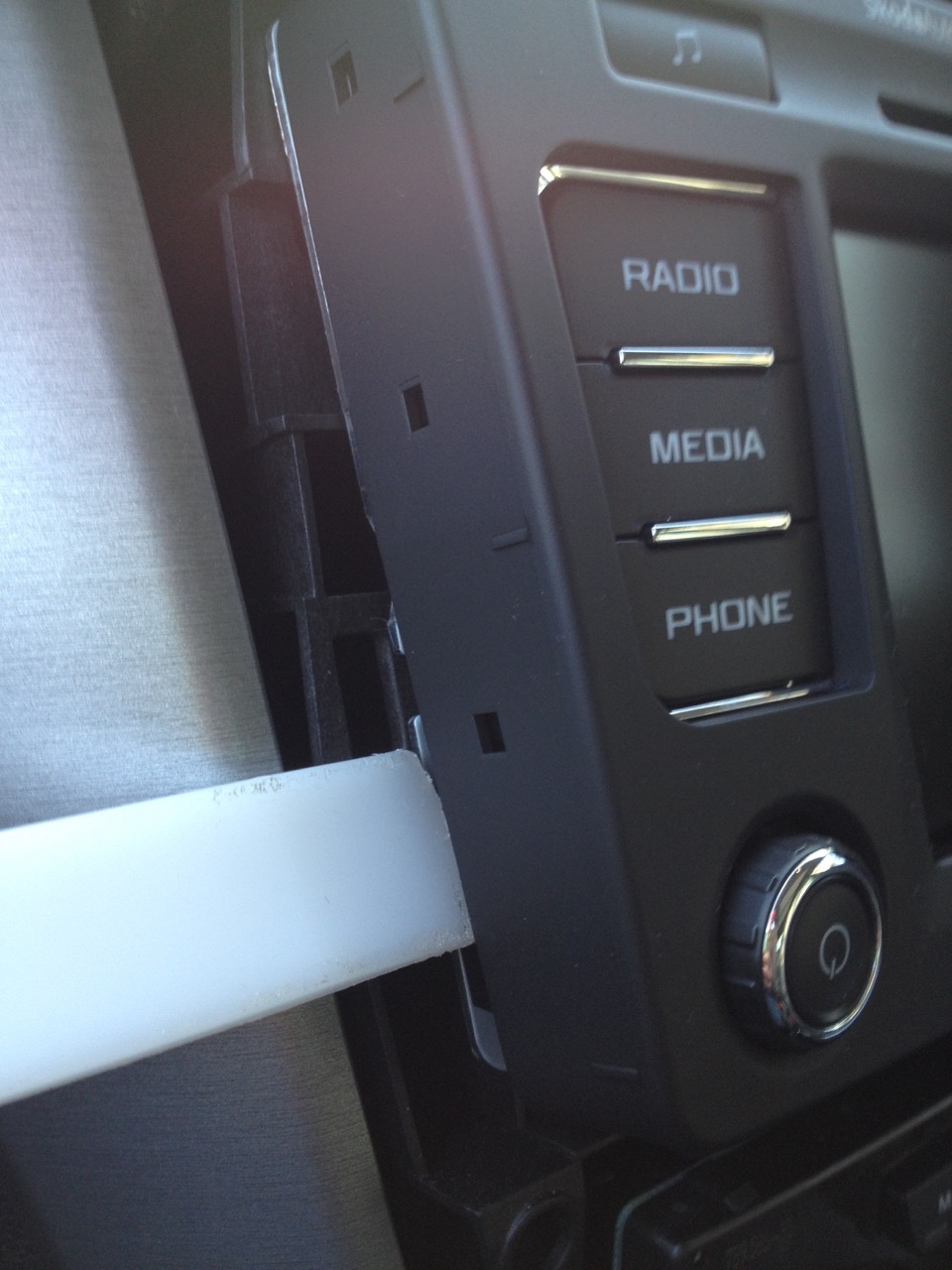

The fascia came off with a little gingerness on my behalf using a plastic trim tool starting on the right, then the bottom and the left. the top appears to be held in by two tabs that, if prised from the top, would probably snap off.

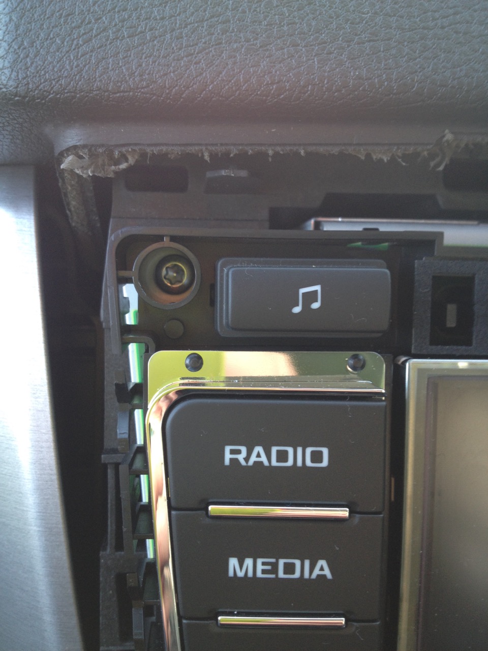

Next was the Bolero face which needs to be removed to get at the four Torx 20 screws that hold it in place. This has three small tabs on each side that are easily overcome with a gentle prise / twist of a trim tool on each side:
post-59543-0-57337400-1416568694_thumb.jpg  post-59543-0-25545900-1416568717_thumb.jpg
This left the following - a naked Bolero!:

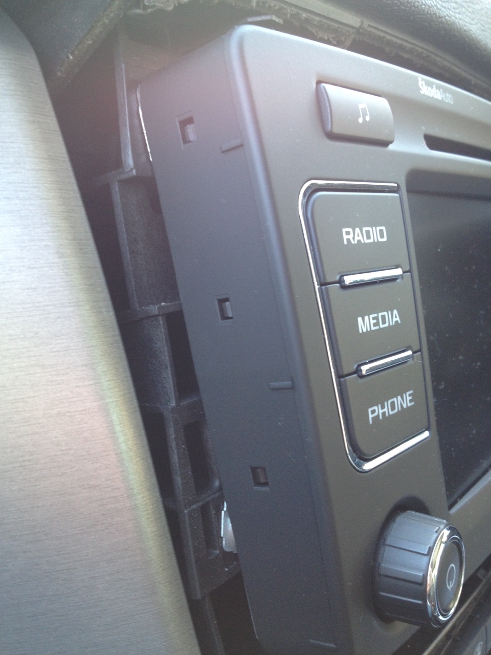

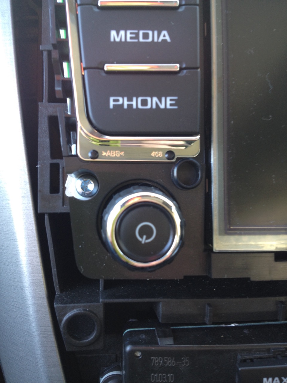

The screws are where expected on the left and mirrored on the right. Unlike the earlier Stream head units, you do not need to be too worried about dropping the screws and them disappearing inside the headunit.
post-59543-0-33556700-1416568750_thumb.jpg  post-59543-0-75454500-1416568781_thumb.jpg
Undo these and slide out the Bolero. There was quite a bit of cable given o be able to get behind the stereo and remove them fairly easily. The shortest was probably the double radio connector (the white double FAKRA connector).

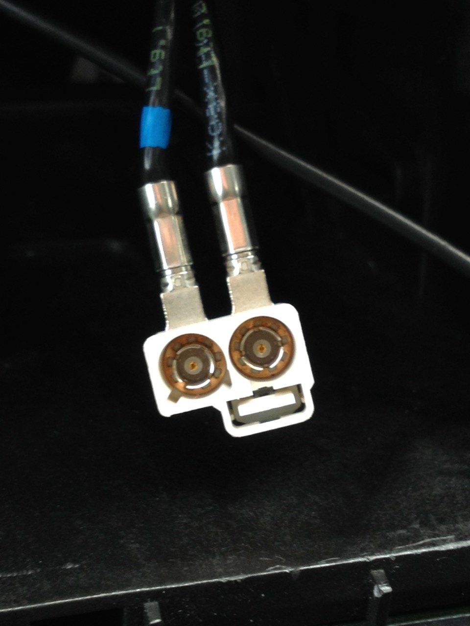

Just out of interest, this is the radio connector. Notice the blue marking on the one black cable? That's the FM only side. The other is FM / AM combined.

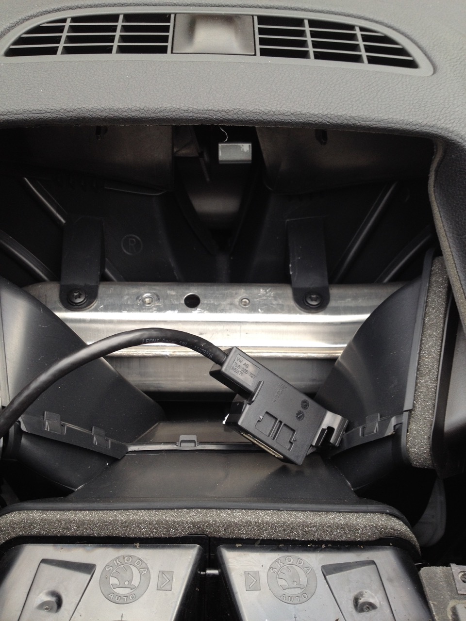

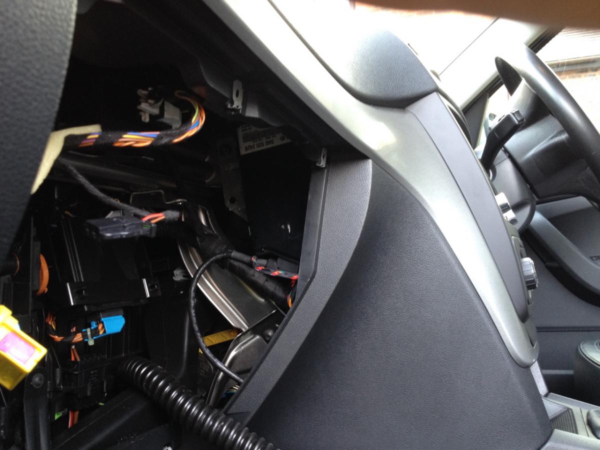

Before putting the Columbus in, I wanted to find out where best to place the MDI controller and cables. I was hoping that, like the Octavia Mk2, there would be a nice mounting point for the controller bracket (p/n 1Z2 035 643):
But there isn't! Or if there is, I didn't find it.

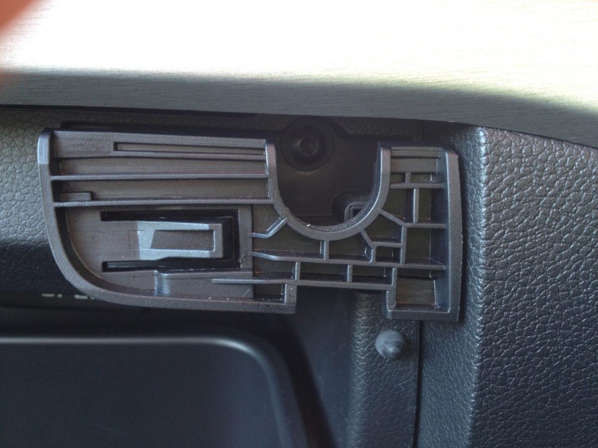

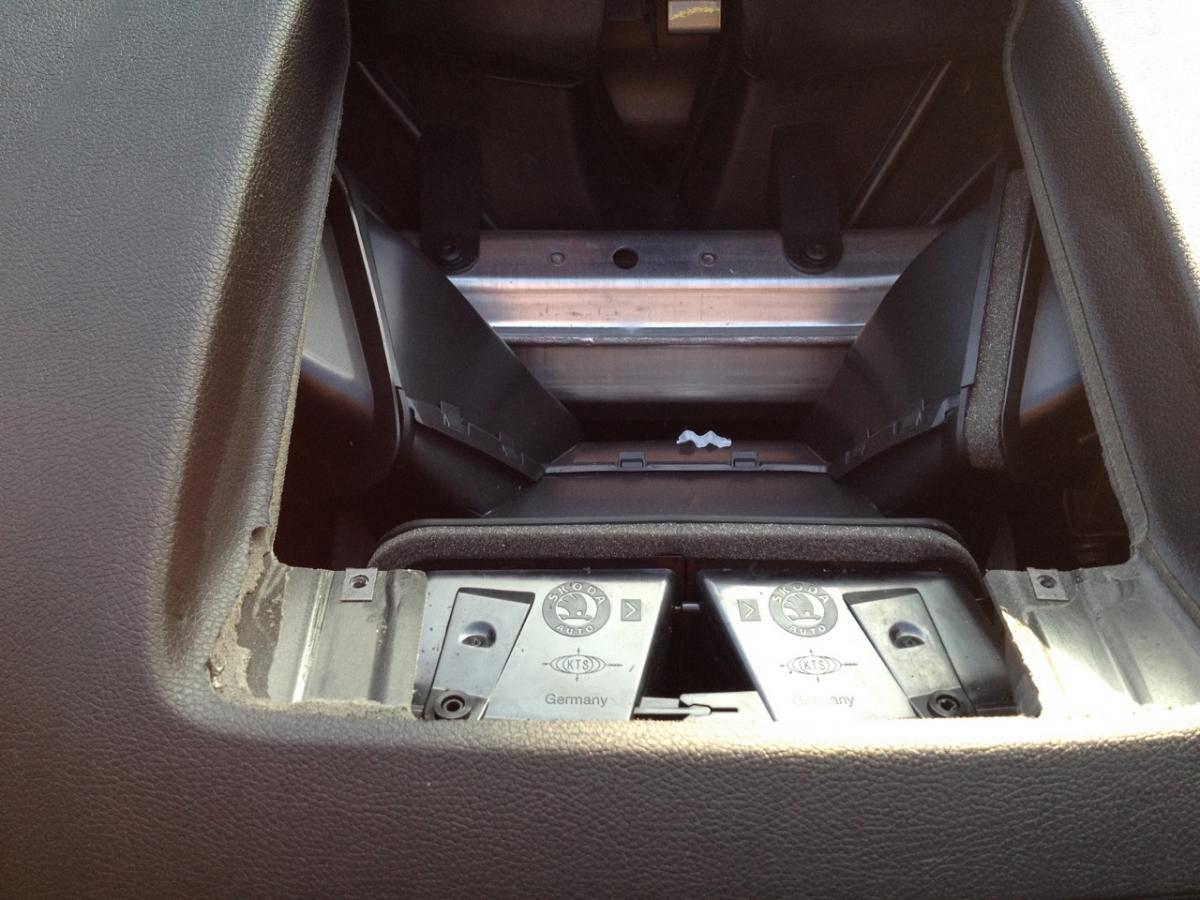

Next step, remove the dash top box and the glovebox. Both of these have been documented on here already (so I won't duplicate, but will link). Thanks to their authors for the information.
Both of these are pretty straightforward with the exception of removing the glove box release button cover. It's a question of playing with it until it works free.

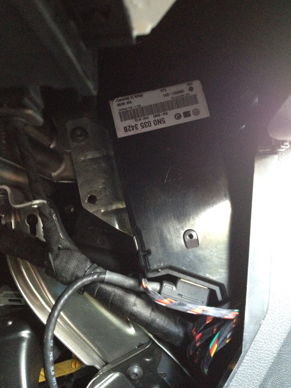

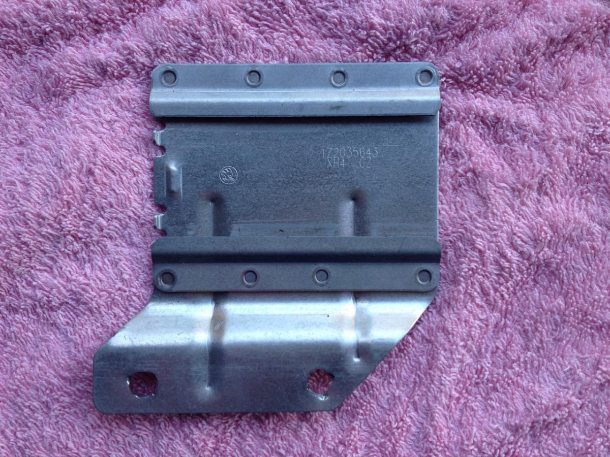

With these out, the most likely location appeared on the cross beam under the dash top box where there were two threaded holes. And I had some Skoda screws with fitted washers that fitted.
These weren't spaced the same as the holes on the bracket - but that could be remedied with a drill - and the bracket would need to be bent differently. Due to the size and shape of the MDI controller, I just could not get the bracket to fit and get the dash top box back on without pushing the controller around too much. There is the space for the controller, and I know someone on here has 'bubble wrapped' their controller and place in on top of the cross beam.
But that wasn't for me as I wanted to find an official location for it and secure it firmly in place. I also would have preferred to use the 'ashtray' as opposed to the dash top box partly because the ashtray is the official location (LHD only) and I use the top box for storage of items in the absence of a drop box by the driver's right knee as in the Octavia Mk2.
The best I could come up with (as no one could answer my questions about the location or parts), was this:
post-59543-0-12501600-1416570094_thumb.jpg  post-59543-0-55216000-1416570074_thumb.jpg
Loads of room there for the controller (although I did have to fit the controller to the bracket before screwing the bracket in as there simply was not the space to slide it on afterwards. The screw was already there - it appears to hold two bits of metal framework for the dash panel together. Obviously had to take a hammer to the bracket to flatten it out, but there was plenty of scope for making it a slightly different shape (other than flat) as there is quite bit of room in that gap.
I was originally going to run the MDI extension cable to the top box, but decided against this as already mentioned. The cable will reach either location from where I have mounted it with reasonable ease.
But this is where it is going to end up:

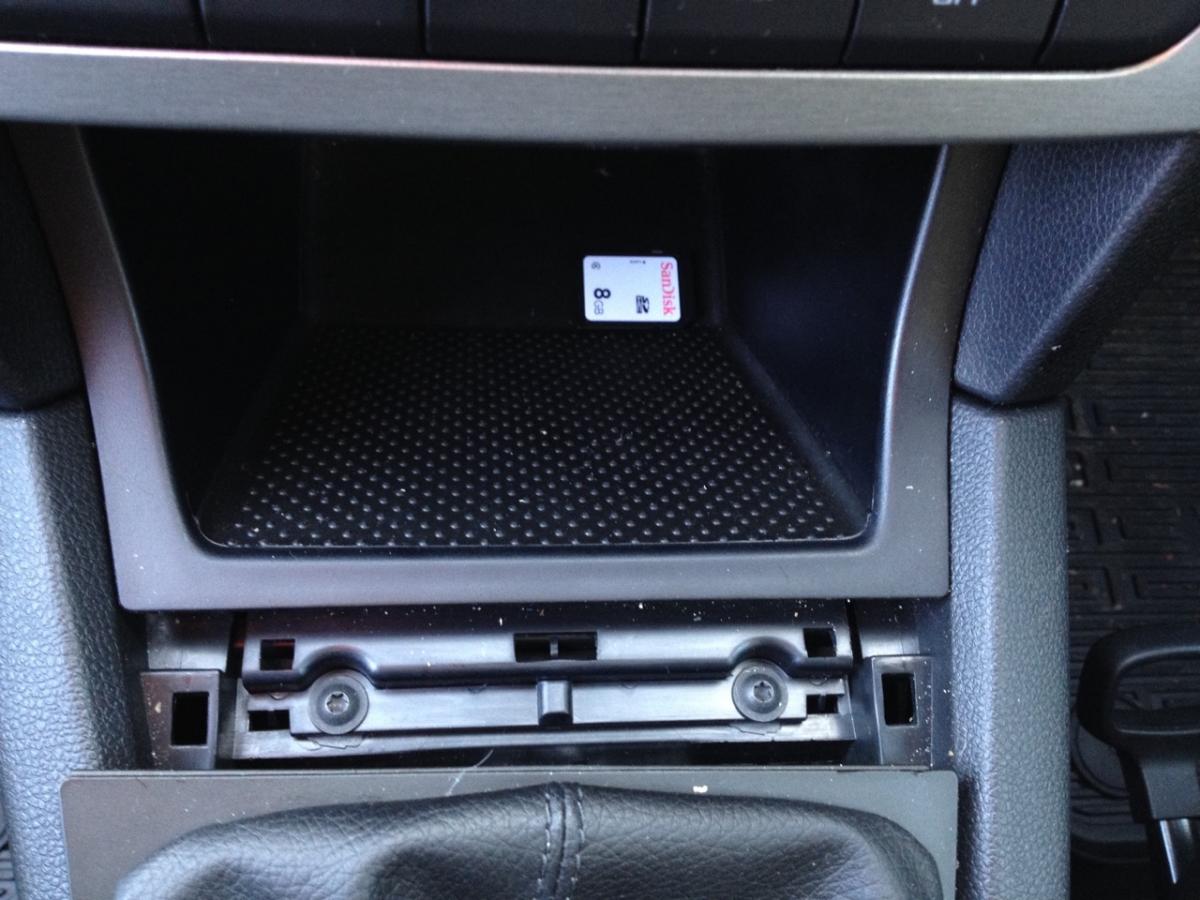

The 'ashtray' does;t just slide out, there are two screws hidden by the gear stick surround. Prise up the rear of the surround (the back of the vehicle) and then the sides and front.

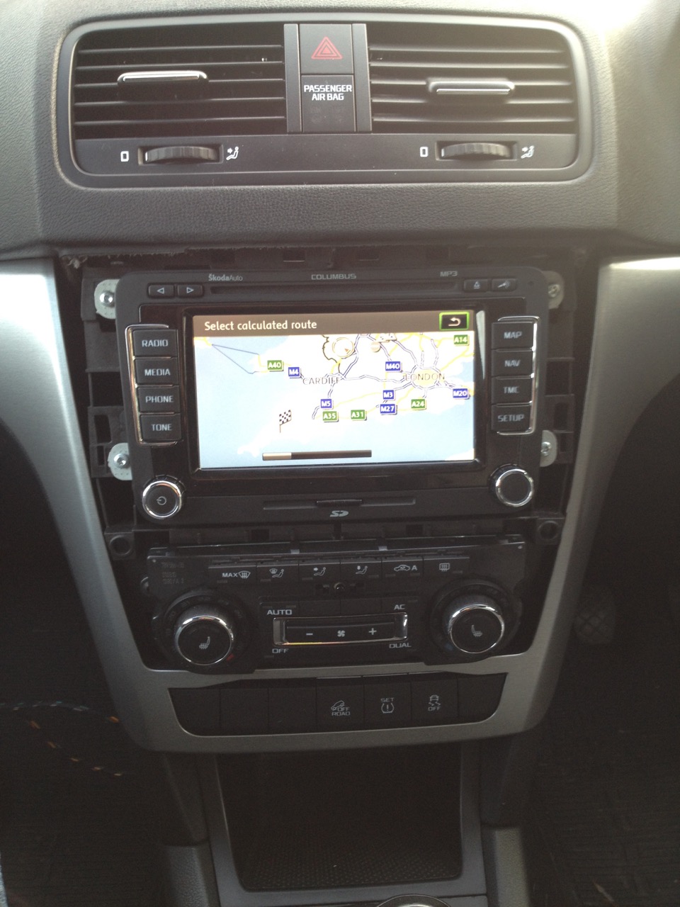

Putting the new fascia on took a little fiddling to get all the tabs in the right place, but then it suddenly fell into place and went in quite easily leaving the end result:

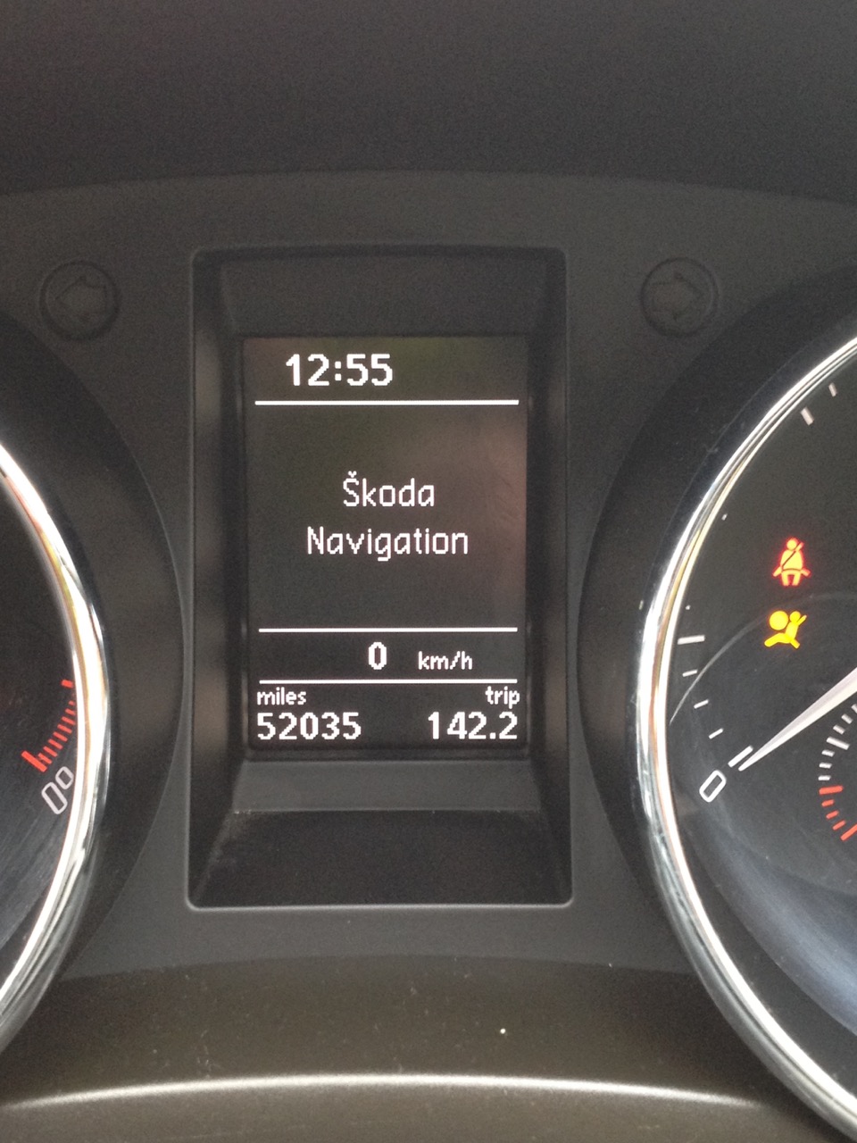

Then on to the VCDS coding to get it all working correctly and integrated with the Maxidot.
VCDS CODING GRAPHICS TO COME LATER
This left an almost fully functional Columbus, Maxidot and MDI.
post-59543-0-25419900-1416570936_thumb.jpg  post-59543-0-64339900-1416570955_thumb.jpg  post-59543-0-45711900-1416571657_thumb.jpg

The new Columbus fascia (5L0 858 069 L 1QB) is slightly different to the original Bolero fascia (5L0 858 069 H) in colouring and texture, but there was no colour code suffix to the part number.
As far as I can establish, there is only one Bolero fascia and one Columbus fascia available.

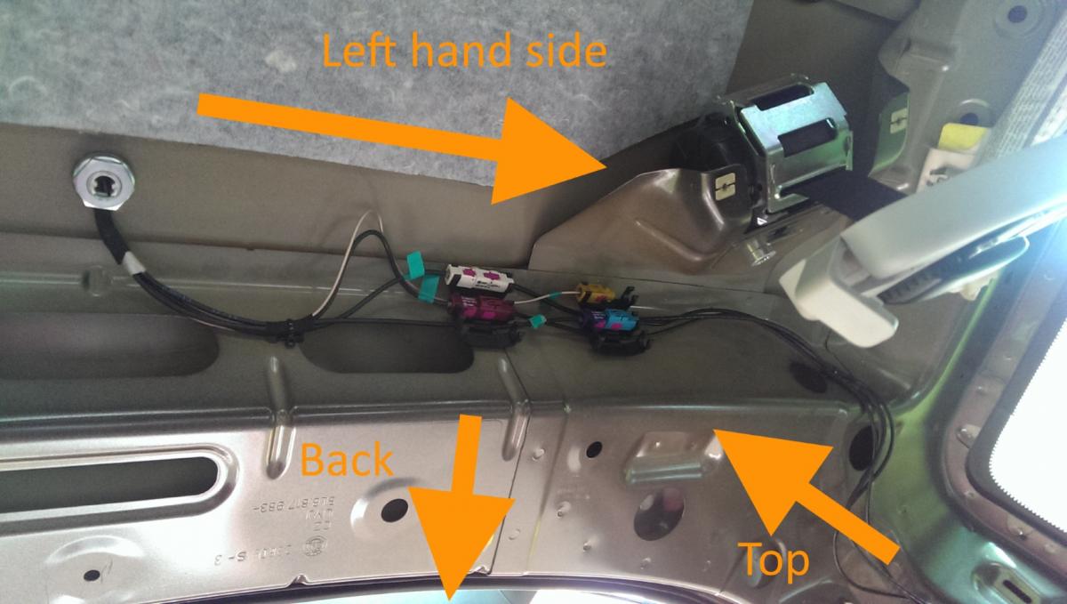

I am also in the process of retrofitting a Columbus + Premium Phone (Bluetooth + Wifi). I want to do it as OEM as possible so I need some info.
I wanted to take the cables for GPS and GSM (each 6m in length) through the same path as the radio antena (left side of the car all the way to the front). The problem is that the car is left hand drive and I hit a bump on how the cables should go from the hood handle up.
For the moment I ended up pulling the cables through the support beam behind the tacho but I am not happy with that and, the GSM cable does not reach underneath the passenger seat (6m too short :( ).
Do any of you have the phone preparation factory made? I cannot find any info to how is the cable supposed to go from the rear antenna to the phone unit (pillars, carpet etc.). Can anybody provide the info, pics etc?
Thanks

The cables run down the D-pillar and along behind the interior boot trim and along under the interior sill trim.
Having put a GPS/GSM/FM/DAB antenna in mine, I ended up running the cables behind the headlining.
I should have removed the whole headlining and done it properly though...
Thanks for the reply.
1. For the reverse, can you tell me where is this setting for the volume dipping ? Maybe it is related to the reverse control module?
2.For the cable direction. I actually removed about half the car to run the cables. Attached is how my car looked like. It is actually quite difficult to get to the cables. I had to remove all the interior of the back of the car, removed the headliner (needed some water leak fixing), removed the back seats, removed the back seats supports (special key needed), pillar trims for all pillars. I've undone all the wiring harnesses on the left side of the car and went down to the front.
I cannot run the cables through the headlined due to the panoramic sun roof and the courtin airbags.
At the moment I think this is not good, although according to some pics I've seen in ELSA this is the direction (left hand side). I need to figure out which way (left side or right side) do the cables run, mainly for the GSM so I need confirmation before loosing a day of work :).
