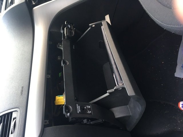

I would like to remove my glove box to run a USB cable from the back of my double din stereo, which I plan to fit soon, into the glove box to use as a phone charger etc.
When my glovebox is open there is a switch for the passenger airbag which will come with it when I remove it. Will this cause me any problems i.e. will the airbag go off or will it be ok if I switch the airbag off?
Hi Mark - I presume that the airbag switch for the front passenger is the one to which you are referring.
You can drop the box sufficiently to gain "access" without having to worry about the disconnecting anything. BUT as a precaution I disconnected the battery and waited 10 minutes before dropping the box. This allows internal capacitors to discharge & ten minutes should be regarded as a minimum.
I would always recommend disconnecting the battery when working in the vicinity of an airbag! Should one go off when your face was very near you could be severely injured! and disconnecting the battery will prevent airbag fault lights which can be generated if you disconnect the Airbag whilst the vehicle is still "alive" as it were. Don't forget to reset your powered windows after reconnecting the battery - the traction control system etc resets itself.

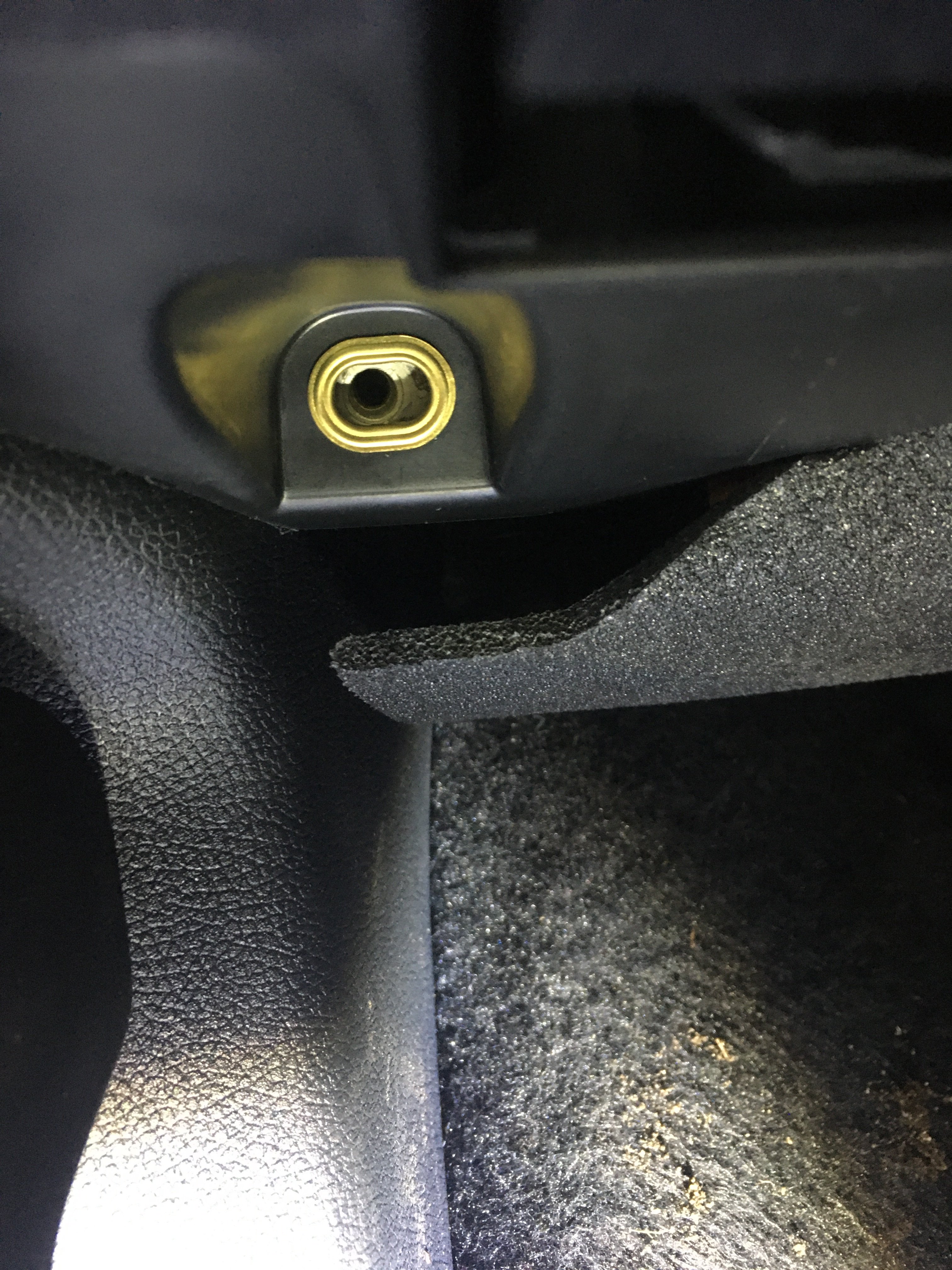

Despite Great Yeti’s excellent pdf, I’m struggling with the removal of my glovebox on my 2016 Yeti.  All five screws are well and truly out, but the glovebox just hangs down on its pivots/axle and won’t budge. What am I missing (apart from some self-esteem after hearing everyone say how “simple” it is :) ?8B0432AA-1328-43B4-AA01-FC3950FDF7AA.jpeg.e6c62aee63b6e15e186f75113a22403e.jpeg
Sorted. The two screws at the bottom are very hard to see and go almost vertical up into the glovebox housing. The two I originally removed were the adjoining trim screws which are clearly visible. I’m adding a photo of the ones you DON’T want to remove!

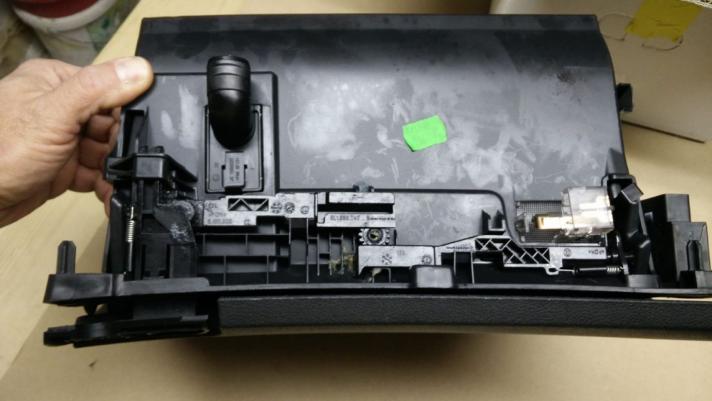

Thanks Great Yeti, I just disassembled the glove box following your directions.
I needed to fix the lock mechanism, I'm attaching a picture to show how it's made to whoever could find it useful:
In my case, the two latches were remaining inside, preventing the box to stay closed.
I just cleaned up everything, oiled anew and shortened by 2 or 3 mm the spring visible on the right of the pic.
Thank you Ulisse :thumbup:. The photograph and information is a very welcome addition to this (now quite old) thread...........Tony
