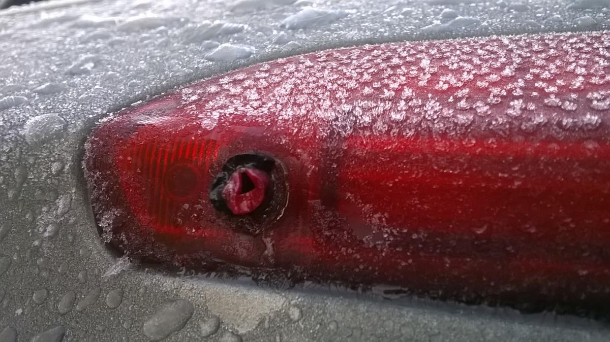

Been like this since Ive had the car, When you operate the rear washer it cleans the windscreen of the car behind!!  Looks to me like its snapped off and is part of the 3rd brakelight.
Question is anyone else with an Estate can tell me if there is supposed to be a bit on the end of this pipe?
Is it a seperate part that you can get or do you have to replace the whole brakelight?

Yeah - you need to remove the light to do it http://www.matthewames.co.uk/briskoda/guides/51175020.pdf
Page 220 to get instructions on removing light
Page 191 for instructions on how to change the nozzle
Never assume everything is cheap on Ebay, ordered one today from main dealer.....£2.98....thanks again lol
